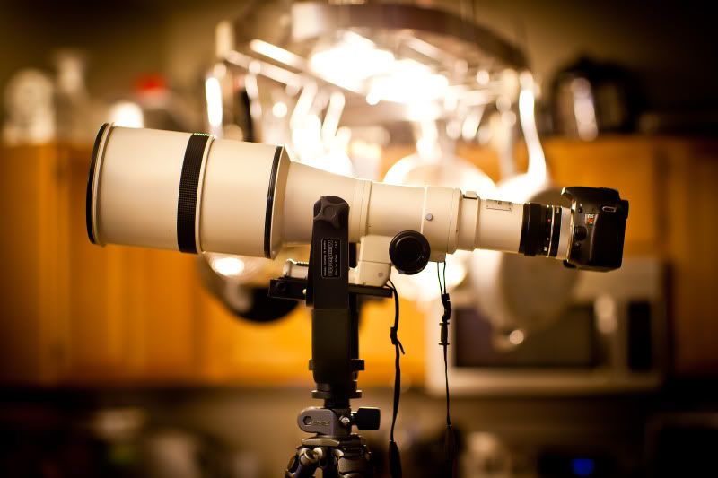

What kind of FD lens are you looking at adapting? Ed Mika has made reversible lens conversions and adapters for most of the higher end FD lenses. I have one I use for my 300 2.8 and 600, it works fine and the lenses focus to infinity. The issue is his adapters aren't cheap so it's not worth adapting a consumer grade lens. Better off just getting a Rokinon, or getting an M42 mount lens if that's your goal.
EdMika Canon FDn-EOS adapter kit 14mm 15mm 17mm 24mm 28mm 35mm 50mm 100mm 135mm (external link)
EdMika Canon FDn FD 85mm 1.2L EOS mount conversion kit (external link)
Canon FD 55mm 1.2 Chrome Nose and SSC versions EOS brass conversion kit (external link)
The do work quite well however, assuming the lens itself is worth the extra investment.
