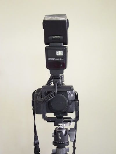

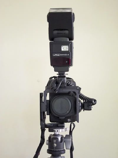

A professional grade bracket will cost about $250-300, but these all accomplish these 3 functions...
  1. Keep flash directly above the axis of the lens, regardless of Landscape vs. Portrait orientation
  2. Allow the camera to be rotated CCW to Portrait position, so that battery grips are in the right hand and the supplemental controls of the battery grip continue to be usable
  3. Keeps the flash pointed up to the ceiling without any additional manual adjustment of flash head orientation
Pro grade products include Newton flash bracket, the higher priced Custom Brackets (but not their cheaper ones!), RRS.
You will find that the $100 products do not do all three... And one of the three (or maybe more) is missing! So if $100 is all you want to spend, you need to decide which of the three functions would be acceptable when missing from the chosen product.
You will also find that many brackets CANNOT accept a camera with battery grip.
The Newton Camera Bracket adapts to both cameras with bracket and cameras without bracket....I can use mine with both my medium format camera with and without motor winder, and with my Canon dSLR both with or without battery grip.

The Newton flash rotator bracket (Newton makes several models, including a camera rotator version)
IMAGE: http://i69.photobucket.com/albums/i63/wiltonw/Equipment/bracket_land.jpg
IMAGE: http://i69.photobucket.com/albums/i63/wiltonw/Equipment/bracketport_01.jpg
IMAGE: http://i69.photobucket.com/albums/i63/wiltonw/Bracket2of2.jpg
IMAGE: http://i69.photobucket.com/albums/i63/wiltonw/Bracket1of2.jpg
