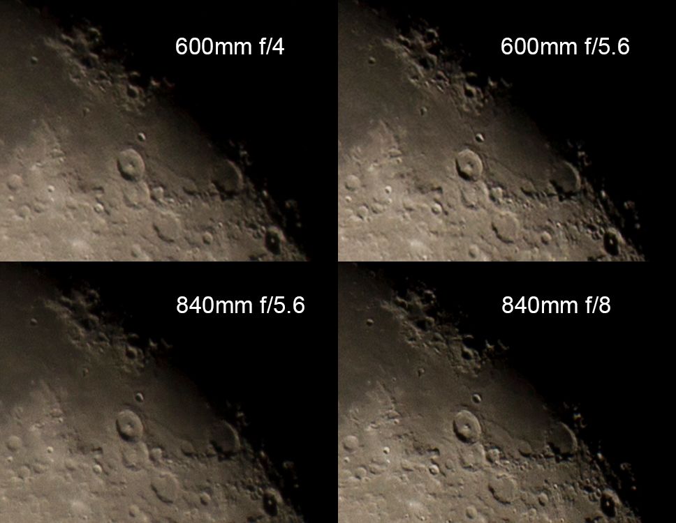

I experimented with and without the extender at different apertures and thought people might be interested to see the results. The bare lens definitely sharpened up from f/4 to f/5.6, but going to f/8 made no further improvement. I made the composite below by taking the same crop from each unprocessed image and resizing so that the image scale is the same. That means the 600mm images are at 100% and the 840mm images are about 70%.
IMAGE: http://i72.photobucket.com/albums/i192/garlicpickle/Canon/MoonTest_zps82c68a96.jpg
You can see from the top images the improvement from f/4 to f/5.6 in both resolution and contrast. Adding the 1.4x extender with the lens wide open (now f/5.6) does increase detail a tiny bit, but one stop down, to f/8, increases detail quite a lot, improving on the bare lens at f/5.6. That shows the extender is well worth using.

Congratulations on the lens, the first light shots look very good and your comparasions are well done. Look forward to seeing some guided shots
