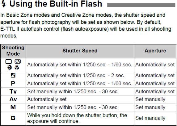

From having actually used and owned a 60D, there is no problem. This is the way the camera works. Canon DSLR's usually set the shutter speed to 1/60 when the built-in flash or a Canon EX-series flash is used
This is clearly documented on page 130 of the 60D's instruction manual.

I agree that M-mode is better for flash photography. That said, neither of the above posts addressed the question.
To force faster shutter speeds, with flash, in Av mode, you need to go to the CUSTOM FUNCTIONS menu. Select the first item: C.Fn I: Exposure. Use the rear wheel to scroll to #7: Flash sync. speed in Av mode. Press the SET button and make your selection from the menu.
0: Auto. Gives you metered shutter speed.
1: 1/250-1/60. Camera makes a selection in this range.
2: 1/250 (fixed). Shutter speed is always 1/250 in Av with flash turned on.
There are a lot of good photographic reasons for leaving this set to 0. I can't think of one good reason for either of the other choices. This is a kludge. You'll learn more about flash photography if you stay in M-mode. If learning how to control your camera is not your thing, set it to P-mode when using flash. That will eliminate your shutter-control problem without forcing you to make other decisions.
