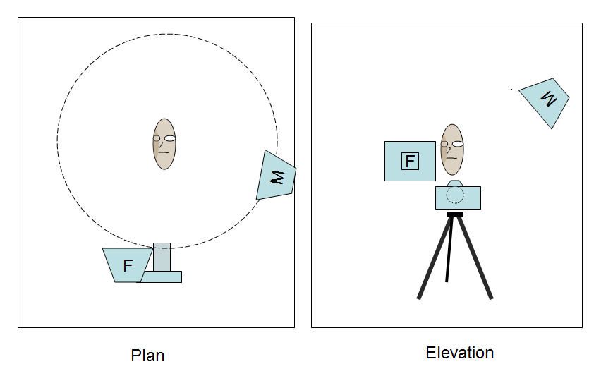

Very simplified fundamental lighting:
Position:
  • Put the 'lower power' flash close to camera position; this is your 'Fill light'.
  • Put the 'higher power' flash off at about 4:30 o'clock or 7:30 o'clock (subject at center of clock, camera at 6:00 o'clock); this is your 'Main light'
  • Make the Fill -1EV less intense than the Main
Elevation:
Put the Main a bit higher than the face in elevation, so it is about 45 degree angle from the face. Put the Fill at about the same level as your camera.
IMAGE: http://i69.photobucket.com/albums/i63/wiltonw/generallighting_zps249caa61.jpg

Wilt
46,422 posts
Likes: 4513
Location: Belmont, CA
Jan 11, 2014 16:24 |  #7
Standard diagrams do nothing to factor in minor adjustments to light position, which are necessitated by the need to better optimize for a given subject's facial shortcomings. Similarly unless an example photo also showed a diagram of exactly the placement used for that person, and also had alternative lighting position diagrams with identical subject posing and how the light placement alters the viewer perception (like HungV's link does), there is limited value of showing example photos.

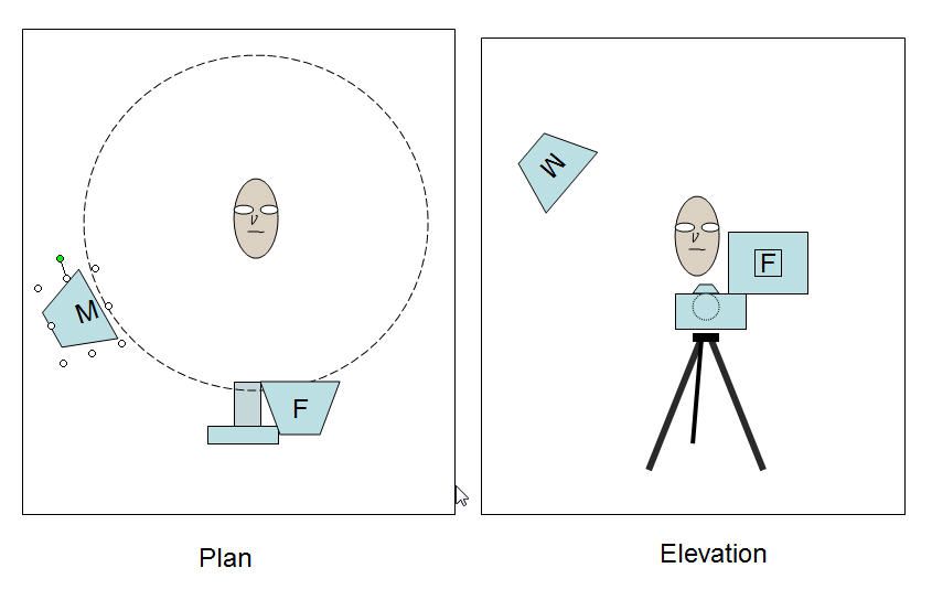

Jan 11, 2014 16:59 |  #8
Examples of slight adjustment due to pose. Post 2 was full face frontal,
but these next two have partial rotation of subject relative to camera lens. Note the changes between 'broad' or 'short' lighting (used for slimmer vs. fuller faces), even with subject in identical position. As they turned a bit more toward the camera, or a bit more away from the camera, the main would move around the circle...perhaps to 7:00 for more facing the lens (not illustrated), while to 8:30 for more facing away from the lens (last illustration) -- merely refinements in Main light position, yet both for 'short' lighting.
Broad
IMAGE: http://i69.photobucket.com/albums/i63/wiltonw/broadlighting_zpsa357de12.jpg
Short
IMAGE: http://i69.photobucket.com/albums/i63/wiltonw/shortlighting_zpsdbe66680.jpg
Even these are generalized illustrations, as one might need to alter height or position to better suit the unique requirements of individual faces. It is this fine tuning which is why I recommend lights with constant source modeling lights, so you can instantly SEE the affects of small adjustments in position, much more easily and rapidly than if using speedlights.
