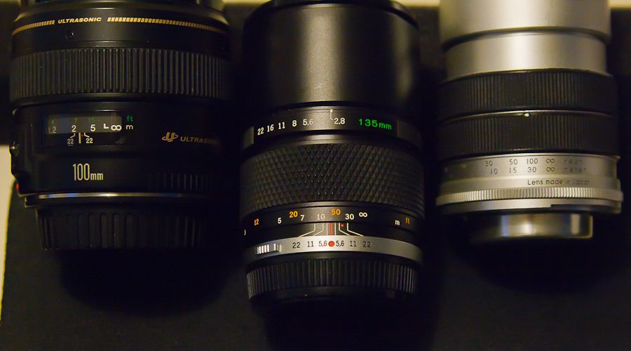

No, you need to abandon trying to use hyperfocal calculators/charts and estimating the distance on the AF lens' distance scale!!!
AF lenses have horribly small distance scales due to the designer wishing to reduce the amount of battery drain cause by an AF motor having to turn the lens focus mechanism through a large rotational distance, making its distance scale much less useful than manual focus lenses of the past. Compare distance scales of the AF lens vs. these two manual focus lenses.
IMAGE: http://i69.photobucket.com/albums/i63/wiltonw/Equipment/Focusscale-1_zps66b331ee.jpg

Wilt wrote in post #16618319 (external link)
I can't estimate the distance on the lens distance scale because I don't have one. No distance scale whatsoever on my lenses... The best I can do is use my eyes and try to estimate the distance of a certain object on my own.
Are you saying that a chart is also useless?
http://www.virginie-bitterlin.com (external link)
http://www.visiting-washington.com (external link)
Instagram (external link) - Facebook (external link)
Canon 6D, Canon T4i/650D, Canon 24-105, 18-135 IS STM, 50 f/1.8, Canon 70-200 f/4, Samyang 14mm f/2.8, Samyang 24mm f/1.4
Wilt
46,463 posts
Likes: 4552
Location: Belmont, CA
Jan 19, 2014 11:02 |  #13
virginie24jb wrote in post #16618334 (external link)
Which Canon lens is totally lacking a distance scale?
I am saying that hyperfocal charts are useful IF YOU CAN estimate the distance on the chart. You can do that with...
  • a manual focus lens (which has a much better scale)
  • a laser distance rangefinder
  • a very long measuring tape
  • a very practiced eye for distance
But then you have to guess wildly to set that distance on the lens or simply focus on a point in the scene measured with one of the above four techniques.
If you have none of those four (and no distance marks on the ground), at best you have a poor guess, and probably ought to simply focus on the primary subject in the scene, ignoring hyperfocal distance. When using a wide angle lens, and a hyperfocal distance which is close and like a distance found on the scale of the lens, you have a much better situation to use hyperfocal charts. Photography 40 years ago -- before zooms were commonly quality lenses, and before AF -- allowed much better practical use of hyperfocal concept than today!
