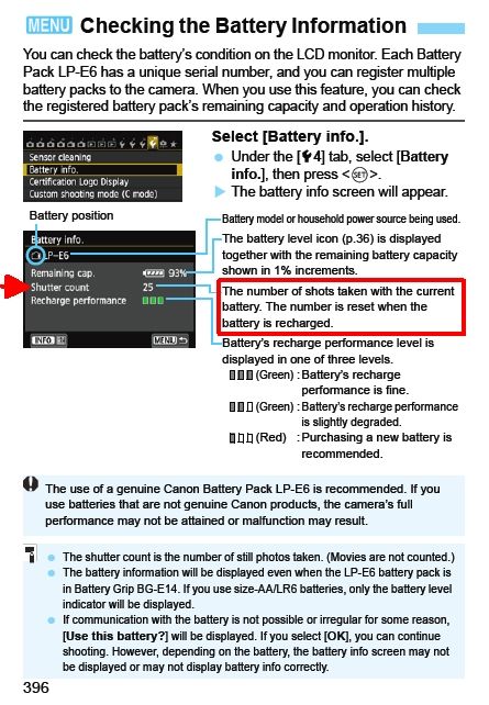

hokiealumnus wrote in post #16628409 (external link)
After turning it on, the photo counter was not reset and it had a whopping 318 photos. That's about a weekend of shooting for me, so this thing has barely been used.
Which "photo counter" are you referring to?
The battery info menu has a "Shutter count" but it only shows the count on that particular battery. It is reset every time you charge the battery or change batteries.
IMAGE: http://i2.photobucket.com/albums/y17/msowsun/photo%20stuff/Photo14/_70Db.jpg~original

msowsun wrote in post #16629299 (external link)
The count I'm referring to is the photo naming count. Unless the prior owner reset it, it was sitting at ~300 when the camera got to me. I could try EOSInfo (external link)to be sure of course, in case that count has been altered before, but the thing was three months old when I bought it and as you can see above, it was clean as a whistle. All that was done was to pull it out of the box and start taking photos. I don't doubt its newness. But hey, EOSInfo is free, so why not try it, yes? It might be next week, but I'll report back with the result. :)
