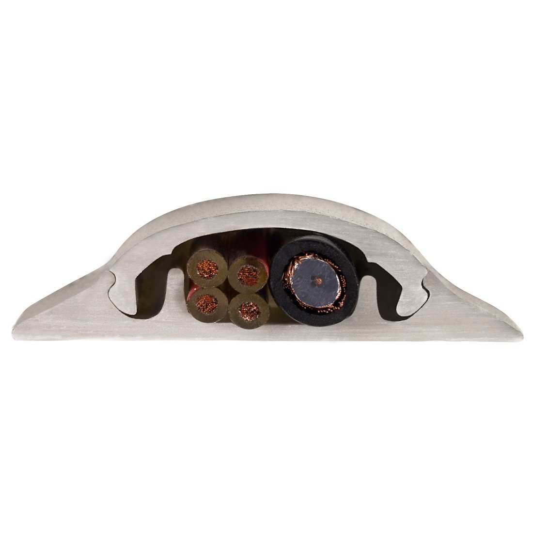

If this is dedicated to photographing kids, do make sure that any and all cables (especially) are
  1. Out of reach if utterly possible. The ideal (impractical here, I know) would be to have everything hanging off a rail system on the ceiling.
  2. Taped down securely if they are in the least accessible. Something likethis Hama product (external link) is ideal - or duct tape! Bet you can't get your cables as organised as this (external link) though! Nor can I.
  3. Light stands, etc are sandbagged.
