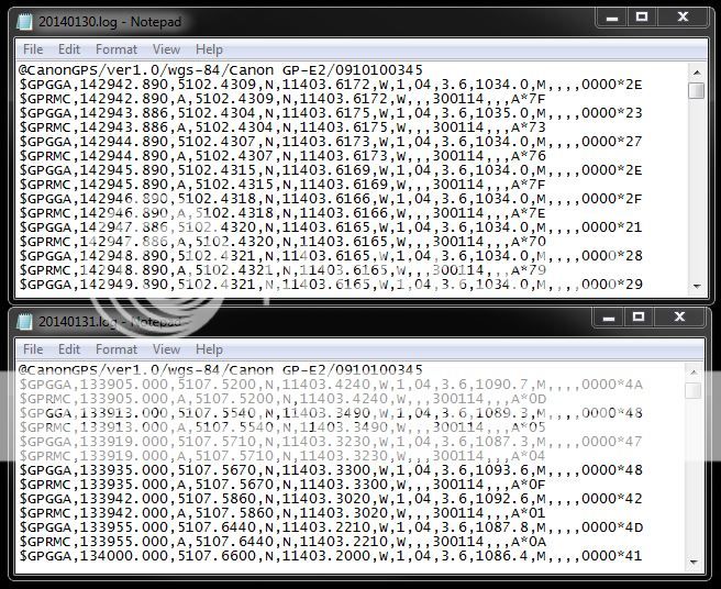

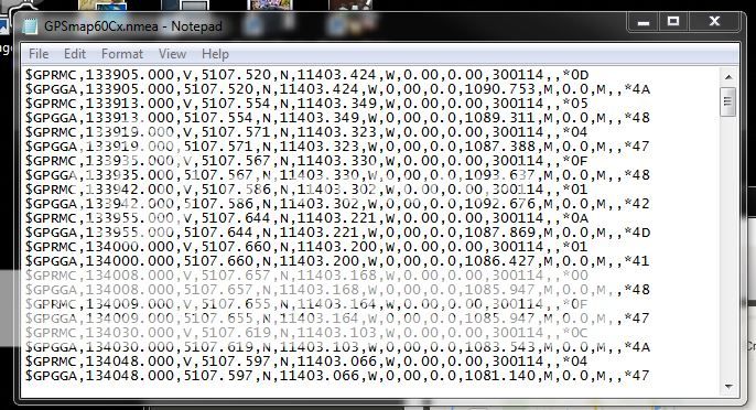

I still don't have .GPX ---> .LOG working yet for Map Utility.
I've been able to nearly duplicate the Canon .LOG file from my GP-E2 with a .GPX from my Garmin GPSMap 60CS using Notepad++ and Excel (after using GPSBabel to convert the .GPX to .NMEA). It wasn't onerous, it just took some well thought out "find and replace" and some sorting. I have to fudge some values, though.
In using this reference:
http://ianrpubs.unl.ed​u/live/ec157/build/ec1​57.pdf (external link)
I have to create my own values for fields 7 & 8 in the $GPGGA sentence. I just copied the values from the first few entries in the .LOG and used those.
The top .LOG in this screen shot is the file out of my GP-E2. The bottom .LOG is created from the .GPX.
IMAGE: http://i1035.photobucket.com/albums/a435/Iasgair/Capture_zps39aa2e7e.jpg
Here's what the nmea file created from the .GPX looked like before I edited it:
IMAGE: http://i1035.photobucket.com/albums/a435/Iasgair/Capture2_zpscc098e95.jpg
The issue has to be with the checksum, which I have no idea how to fix.
