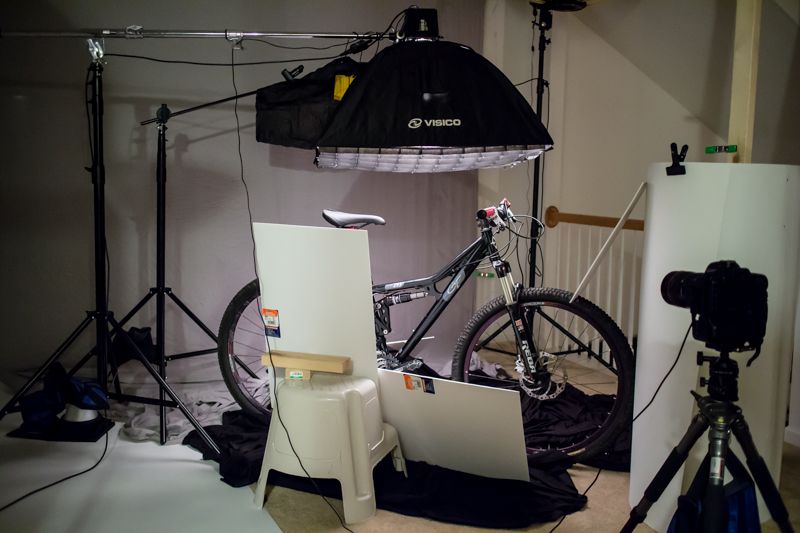

You can use the baby pin right in the D200. I do this when using a beauty dish because you can't tilt he strobe head down otherwise. The forward mount location of an Alien Bee means that when you try to angle it down, the modifier hits the lightstand and inhibits movement. Granted if you're not using Alien Bees it's not too likely to be an issue. ;) I just like to point it out because it's something that used to frustrate me. :confused:
You can see what I'm talking about here:
IMAGE: http://i103.photobucket.com/albums/m140/volvo-1/setups/_MG_0562_zpsdf569057.jpg
IMAGE LINK: http://s103.photobucke​t.com …0562_zpsdf56905​7.jpg.html  (external link)

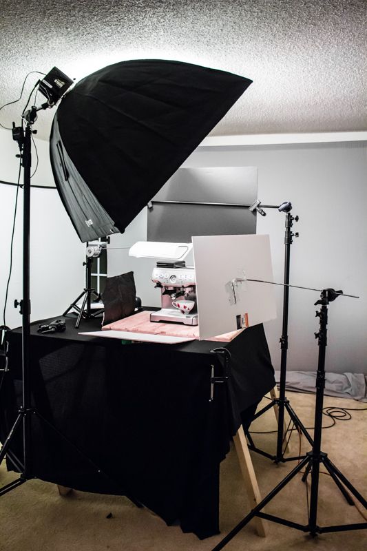

Got the arm and pin today. Is the arm in right? Where the heck does the pin go?
IMAGE: http://markrichman.zenfolio.com/img/s5/v119/p335470387-4.jpg
IMAGE: http://markrichman.zenfolio.com/img/s5/v120/p109467717-4.jpg
Scatterbrained
8,511 posts
Gallery: 267 photos
Best ofs: 12
Likes: 4607
Feb 14, 2014 20:39 |  #15
That's not where the arm goes. The plate is supposed to drop down with the friction disc.
