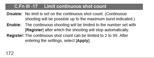

The frames per second or buffer on my SL1 and 5D3 are unaffected by Highlight tone priority or Auto Lighting optimizer.
Chromatic Aberration correction also does not effect FPS, but it will reduce the buffer on my SL1, but not my 5D3.
The 1D3 is too old to have Chromatic Aberration correction or Auto Lighting Optimizer, so my bet is on the Custom Function just as Anders said.

The bottom-line is High-ISO noise-reduction, ISO Safety-Shift, Higher-ISO speeds and RAW format do not have a major impact on "raw" processing speed, but DO SENSIBLY affect buffer-depth, which once filled-up everyone knows what happens with overall system speed.
The killer-whale of the pack, here, is High-ISO Noise Reduction. Just setting that alone leaves you with a 14-shot deep buffer, either in .JPG or RAW (it will not matter). Next one is ISO-Safety-Shift, followed closely by ISO-speed increments, mostly because of on-board computer's conservative ESTIMATE of buffer depth assuming a large variance of file sizes with floating ISO speeds, between 100 and 3200. In the latter case, you usually have substantially more buffer depth than that reported on the view finder.
HTP (which is probably the only on-board tonal processing gizmo worth having), has little-to-no impact on 1D3's overall performance, either in processing speed or buffer depth.
