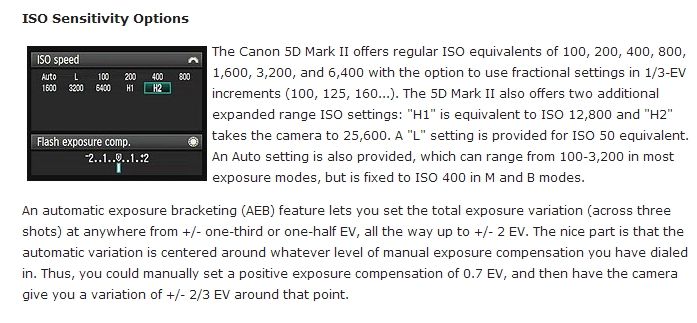

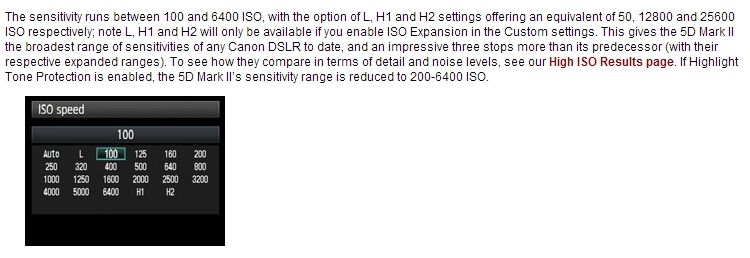

Feb 24, 2014 09:52 |  #12
Lowner wrote in post #16713192 (external link)
I took the camera in to my local photo shop and Jim the manager has sorted it so that I can simply select H1 or H2 in the top plate LCD. The instructions I tried to follow do not explain that H1/H2 is only visible (and selectable) in that display. Simple soul that I am, I fully expected them to be selectable via the rear LCD unless told otherwise!
I think Jim is wrong. Both these reviews show you can select H1 or H2 on the rear LCD with the 5D Mk II.
http://www.imaging-resource.com/PRODS/E5D​2/E5D2A5.HTM (external link)
IMAGE: http://i2.photobucket.com/albums/y17/msowsun/photo%20stuff/Photo14/_5diso.jpg~original
http://www.cameralabs.​com …EOS_5D_Mark_II/​lens.shtml (external link)
IMAGE: http://i2.photobucket.com/albums/y17/msowsun/photo%20stuff/Photo14/_5D2iso.jpg~original

Feb 24, 2014 11:10 |  #13
Are you sure you didn't leave Cfn II-3 in the "ON" state, and all Jim did was shut that off, and turned on Cfn I-3 to "ON"? Whatever is selectable in the top display would show up on the rear display.
