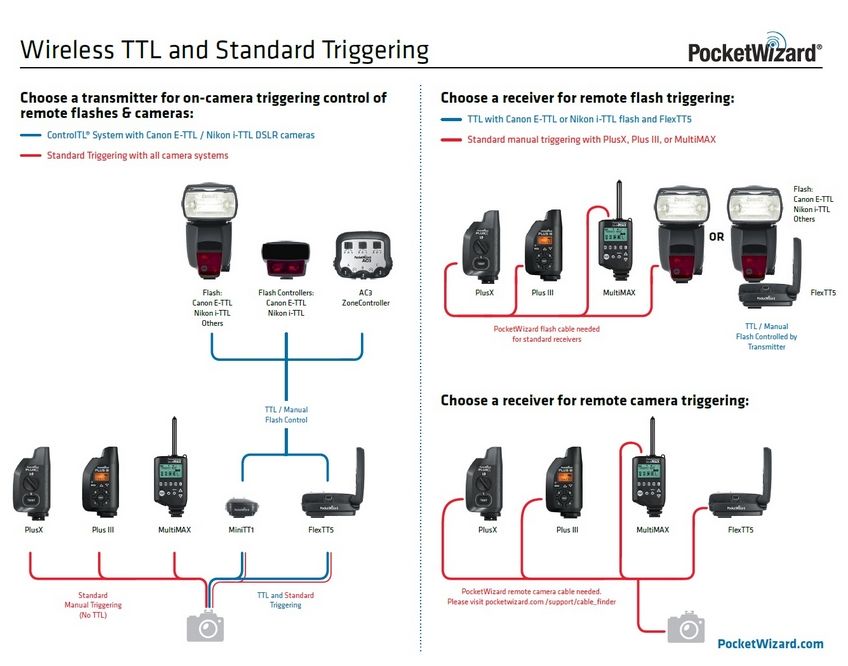

I don't know much about Pocket Wizards, but I see they make a bunch of different products. Which ones do you have?
Is this the first time you are trying to use them? Or have you used them successfully before?
IMAGE: http://i2.photobucket.com/albums/y17/msowsun/photo%20stuff/Photo14/_PW2.jpg~original
