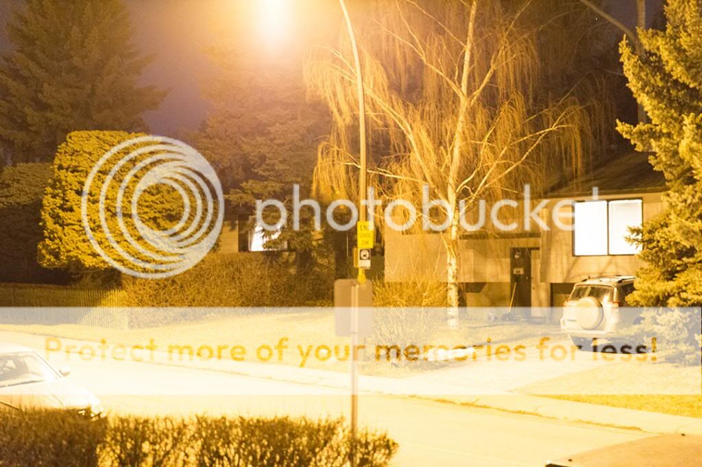

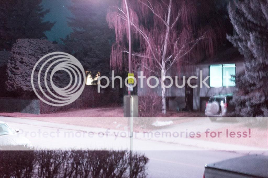

My Astonomic CLS has arrived, and I played with it a bit last night.
Here are a couple of handheld, blurry, test images:
Without the filter:
IMAGE: http://i1035.photobucket.com/albums/a435/Iasgair/IMG_1279_zps1da4a746.jpg
With the filter:
IMAGE: http://i1035.photobucket.com/albums/a435/Iasgair/IMG_1278_zps2e7ac549.jpg
It nuked the high pressure sodium vapour, which is exactly what I was hoping for.

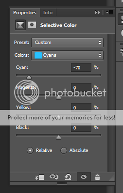

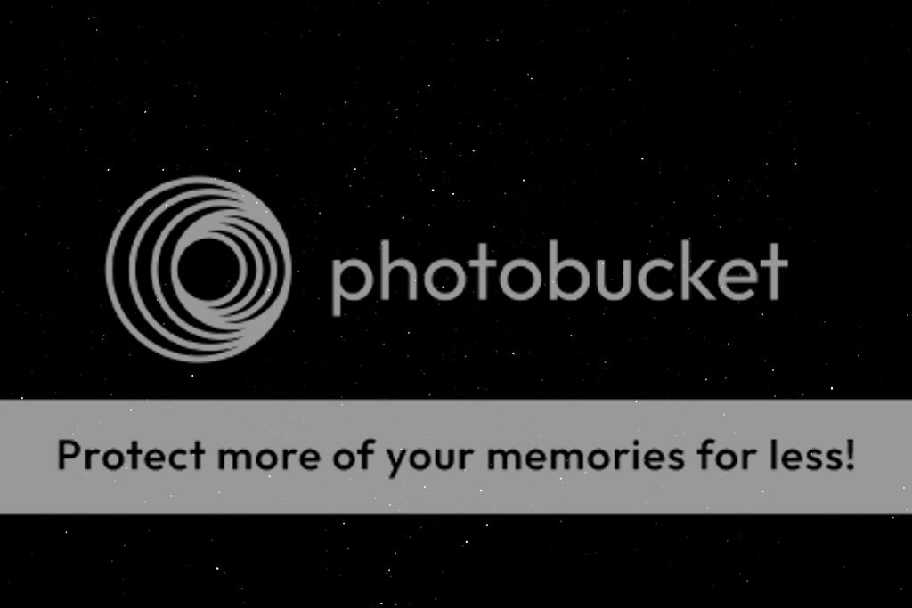

The cyan cast to the final images (it has not been corrected above) is a colossal pain in the backside to deal with. Based on my reading I suspected it would be, but it is frustrating.
I was able to remove most of the cast in this image in Photoshop:
IMAGE: http://i1035.photobucket.com/albums/a435/Iasgair/test_zps2343cf8a.jpg
I adjusted the cyan slider way down in the "Selective Color" toolbox.
IMAGE: http://i1035.photobucket.com/albums/a435/Iasgair/Capture_zps092391ab.png
I didn't eliminate all of the cast, as you can see from the celestial image. It will be a lot of work to get all of it out.
The white balance of the image becomes completely whacked: to the point where I have no idea what to do with it (yet).
