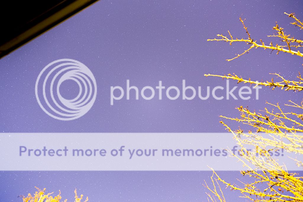

In the event I'm stacking images that have a bit of foreground, will that mess up the resulting stack?
Here is one of the images I'm playing with, which was taken this morning (not a serious attempt, I'm just trying to learn Backyard EOS and DeepSkyStacker):
IMAGE: http://i1035.photobucket.com/albums/a435/Iasgair/LIGHT_Tv25s_6400iso_f2-8_18c_03268stdev_20140311-05h10m2_zps643cf7b6.jpg
My crabapple tree, lilac bush, and eavestrough are in the photo as I just set the camera up on our back deck. The image has had the WB set to 3100K (to try to offset the orange/pink glow), and lens distortion and corrections have been made. I haven't changed anything else.
This is what I'm getting out of DeepSkyStacker:
IMAGE: http://i1035.photobucket.com/albums/a435/Iasgair/Autosave_zps40643fee.jpg
I can't do a thing with it. I've tried processing over and over again, and I'm just not winding up with anything I can work with. A variety of bad things have happened: totally grey image where nothing is really visible, pink image where nothing is visible. The images I'm winding up with far exceed my skills on the post end. I've tried it with the Raw files, and with the corrected .Tifs (corrected as the one above has been corrected).
Is it the foreground that is messing things up?

1) Foreground objects on stacks will not work right. Remember, the sky is moving, you and the foreground are not. So when you go to stack, the sky has moved and the foreground image has not. So focus on the sky portion of the stack, not the foreground. The foreground typically is better off left as a single exposure, use masks, and just keep a sharp and well exposed version of an exposure you make that is not worried about the sky and focuses on the foreground portion. Blend the two after you stack so you have a stacked sky and a foreground section that is appropriate. These are always composites. DSS does not do well with objects in the scene.
Follow this tutorial, it works. (external link)
Also note, you don't always need to stack. That first image you showed, with a mask/layer, you can just apply levels/curves/contrast to the sky and process the foreground separately and make a good image. Stacking is not always the answer. Poor stacking results in a noisier or weird image often. Stacking requires planning. You don't just take 10 exposures and stack and expect it to be better than a single frame. See the tutorial.

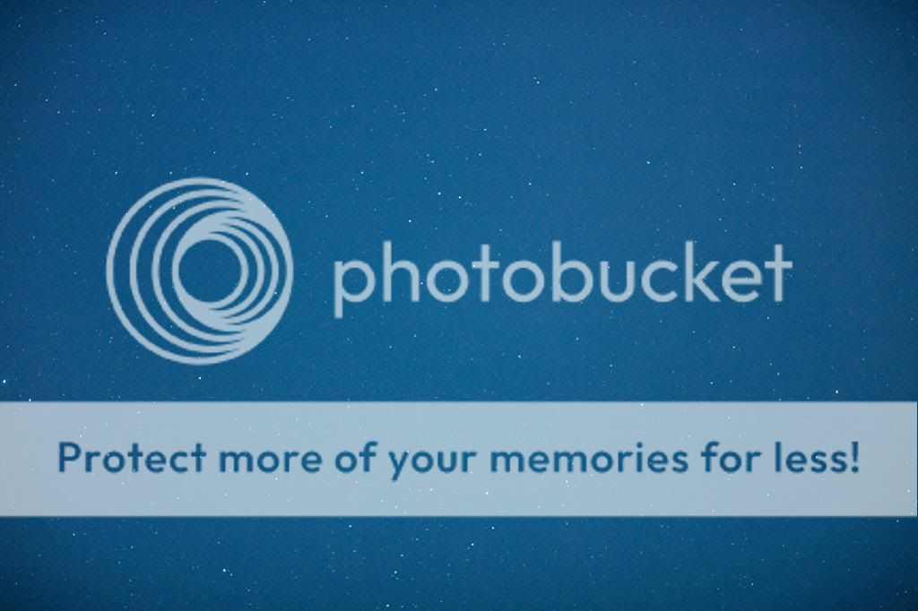

I had much better luck last night with DeepSkyStacker:
IMAGE: http://i1035.photobucket.com/albums/a435/Iasgair/test_zps2343cf8a.jpg
I took 20 each of the flats, dark flats, bias, and dark frames. I took 80 subs, but it only stacked 6 of them. I'm pretty pleased with the results, none-the-less. The images were taken at ISO6400, they appear correctly aligned, and I don't see a spec of noise. :) I'm going to try ISO 12800 next, to boost my exposure time. It was 8 seconds for these subs.
Most of the subs may have been rejected as thin clouds were rolling in and out. The photos were taken inside a "white zone." There are many more stars in the final image than I could see with the naked eye.
There is still a touch of cyan colour due to the Astronomic CLS filter I now have (and used) for my 6D.
In giving DeepSkyStacker a better set of images, I definitely got better results.

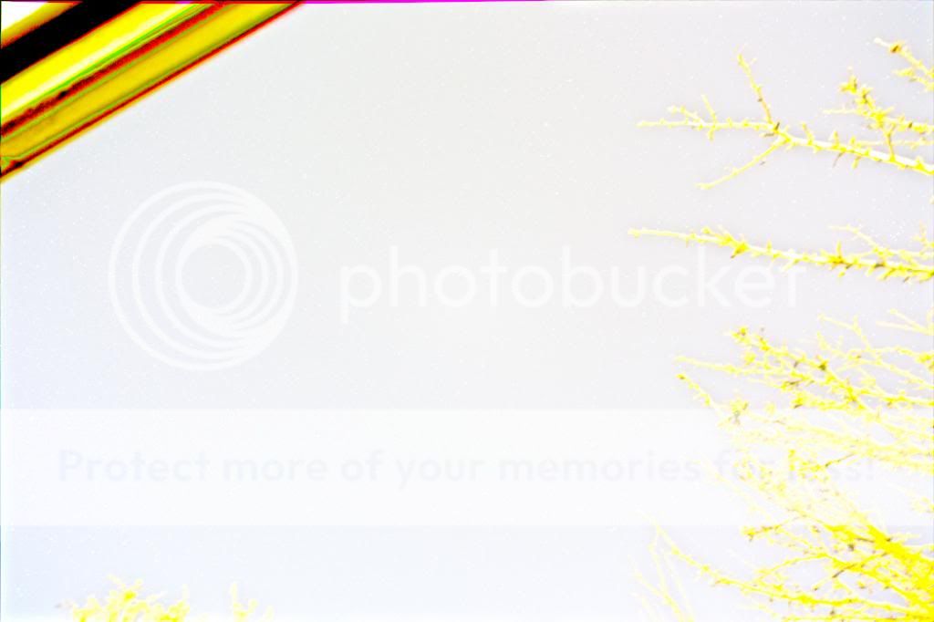

IMAGE: http://i1035.photobucket.com/albums/a435/Iasgair/TEST_LIGHT_Tv8s_6400iso_f2-8_13c_CLS_00770stdev_20140318-21h03m49s239ms_zps42d9b6d6.jpg
All I've done to that image is resize it and save it to jpeg. Note that I think this image may be significantly underexposed. I'm still trying to sort exposure out.
Edit: It looks like Photobucket stripped the EXIF. I'll see if I can fix that.
Edit2: I can't find the setting in Photobucket. 8" ISO 6400 F2.8
Oops. Sorry. I just noticed that you asked for a sub that was used. I don't know how to figure that out. The one I've posted may, or may not, have been used.

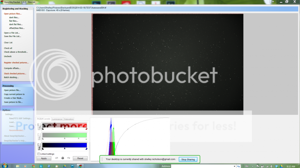

I just ran it again:
IMAGE: http://i1035.photobucket.com/albums/a435/Iasgair/Capture_zpsbf22d1cc.png
I ran it a bit differently this time, so the final image isn't blue, but there is an obvious vignette.
It stacked 6 frames (according to the top bar), but there doesn't seem to be anything I can click on to tell me what frames it used. I need to do some more reading.

So I tested it just off your JPEG, and honestly, I really recommend you spend less time trying to do stacks, especially with only a few frames. When you stack with less frames, you actually introduce noise and problems, not just retract them. I compared your stacked image to an edit of your single sub that you just posted, and with a simple curve adjustment and contrast adjustment, they looked essentially the same. That tells me that you need to work more on simply doing a single exposure with more information in it.
When you do an exposure, try adjusting it's color temperature in your RAW software. Then export and adjust contrast. You'll see the same image basically.
Again, stacking is useful when you have a good single image, but it's noisy, and then take like 20+ working light frames, some flats and darks and, again 20+ each, and generate a good master file that it then works from. But a single frame should still be a workable image. Stacking doesn't generate information--it takes information out.
Also, without EXIF, wasn't sure how long exposure time was. On that 6D, with a 24mm lens, you should be able to easily do 30 second exposures at 6400 and get a clean single image.
