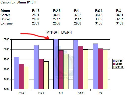

Mar 13, 2014 09:13 |  #15
I know you can have a tough time balancing shutter speed, aperture and keeping the ISO down. You lens is sharpest at f4. You can see this on the MTF chart. Depending how close you are and deeper DOF like f4 will be less critical like when Tom pointed out the hand if the coach was in focus instead of the eyes in the very first post. You can always fix noise but you can't fix motion blur or badly out of focus images.
IMAGE: http://i33.photobucket.com/albums/d74/Zenon1/Tests/mtf_zps6914fec2.jpg
It may be tough but I would try for about 1/1000 shutter speed, at least. I was shooting night football and was maxed out on my 7D. ISO 12,800, f4 (fastest my lens could do) and 1/500 was the fastest shutter speed I could get. I was still getting motion blur at the hands and feet.
