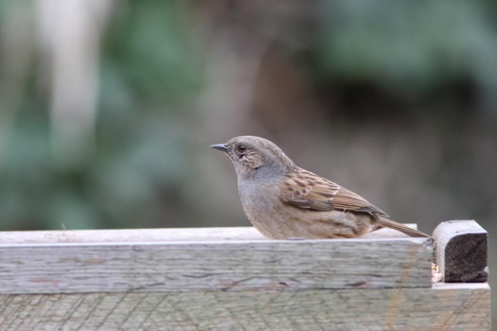

Just a quick snap to give an example with my 7d
Below is a snap taken with my 40d (same lens)

Mar 16, 2014 05:22 |  #9
Have you mfa'd your lenses on the 7d?
For that shot , you would want spot AF, to cut thru the branches, what AF mode was used?
It is very clear on that shot that the bird is outside the focus area, and instead the leaves/branches in the front are in focus. This is either a MFA lens thing, or the incorrect AF mode was used (like all points, etc). The last thing I would bring up is that I am not convinced 1/500th at 400mm on an 18mpx sensor is fast enough to stop all blur, even with IS. You may want to run your shutter speed up a bit.
The 40D image isn't particularly clear either. The same problem most likely occurred here, 1/125 at 560mm is entirely too slow for shooting wildlife.
In summary, with the 7D:
- turn ALO off
- MFA your lenses to your body
- Make sure your shutter speeds are at least 1/(1.6 x focal length), even with IS, especially due to the 18mpx dense APS-C sensor
- When shooting birds in the middle of leaves and branches, go to spot AF
