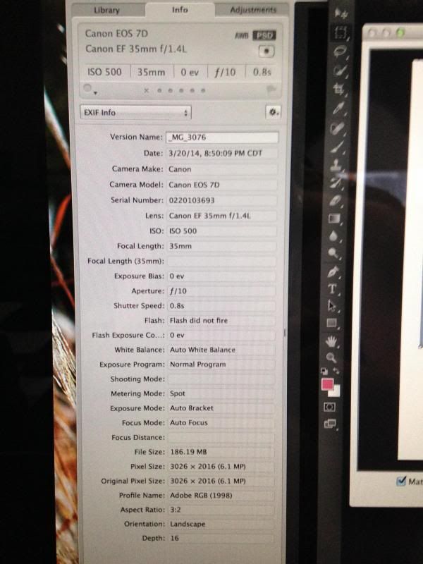

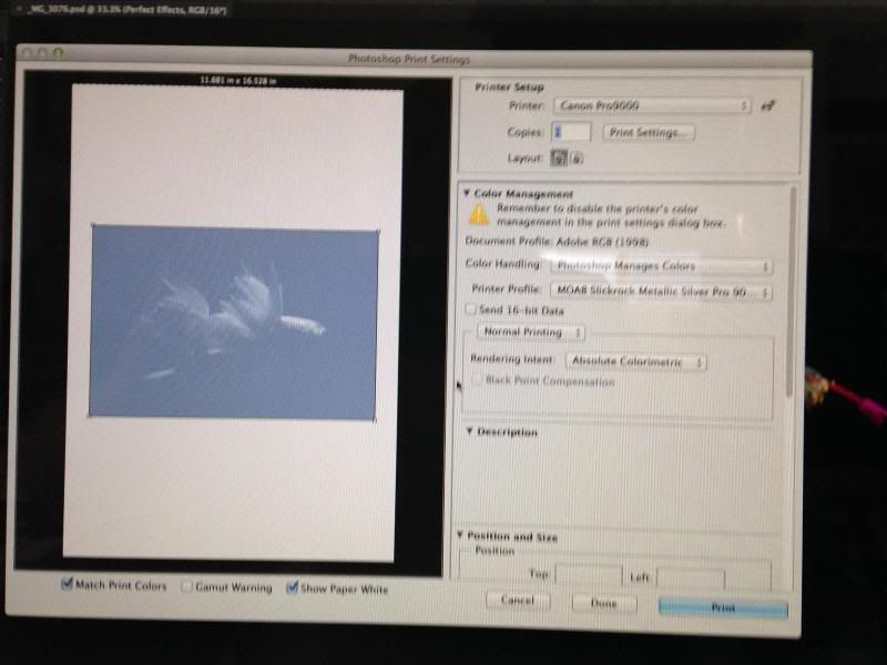

Below are two images from my computer. I'm trying to print a image that I edited using MacPhun Intensify Pro and print using CS6. Intensify Pro saves it as a psd file. BUT when I open it thru Aperture in CS6 as a plugin and try to print it the image is "grayed out" and when I print it is also grayed out.
Any solution??

Wanting to print on canvas and PS I'm able to use my ICC Profiles.

Can you open the PSD from MacPhun directly in PS CS6? Do you get any different result (why open it through aperture?). Whey you say the image is "grayed out", what does that mean? Does it mean that the contrast is flattened and blacks appear gray? Or is some option to print not available?
Also, why are you using Absolute Colorimetric rendering intent?
