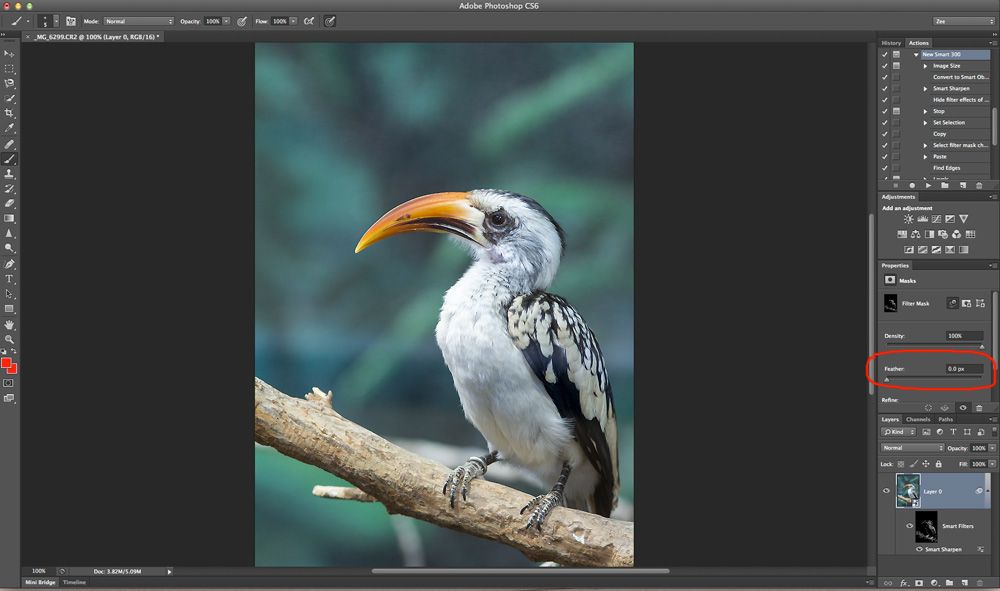

I have a lengthily tutorial on one of my favourite output sharpening methods but recently made some changes that has made it a bit more simple. If you want to see some of the steps in more detail you can check the RSS at POTN link. I use for single hobby or web images as it really is impractical for many images unless you have time. I use LR and rely on the output sharpening for multiple files.

Note: For resizing this is just for making the image smaller, not larger. If you want to increase an image you should watch the Resizing video. For Sharpening I use Smart Sharpen, Amount 300, Radius 0.5 and Remove = Lens Blur.

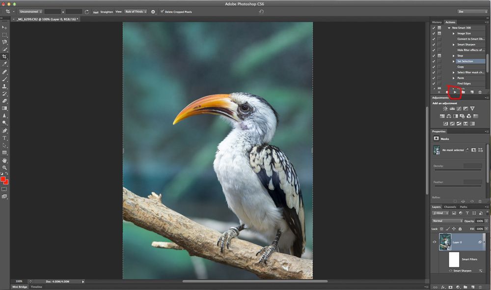

OK here is the basic image.
1. Press the play button - circled
IMAGE: http://i33.photobucket.com/albums/d74/Zenon1/New%20RSS/Image-1_zps54c87e26.jpg

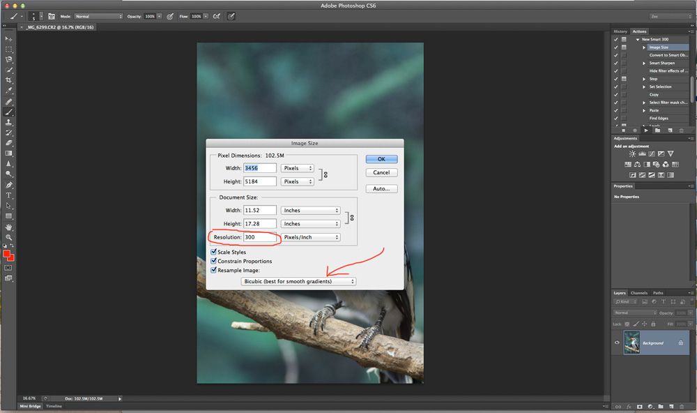

2. The action stops and Image Size dialogue box comes up. Enter the height or width you want and press OK.
Note: Resolution is 300 because it does matter for screen viewing and I'm just on Bicubic because the dude in the video said I should be. He explains why in the Resizing video.

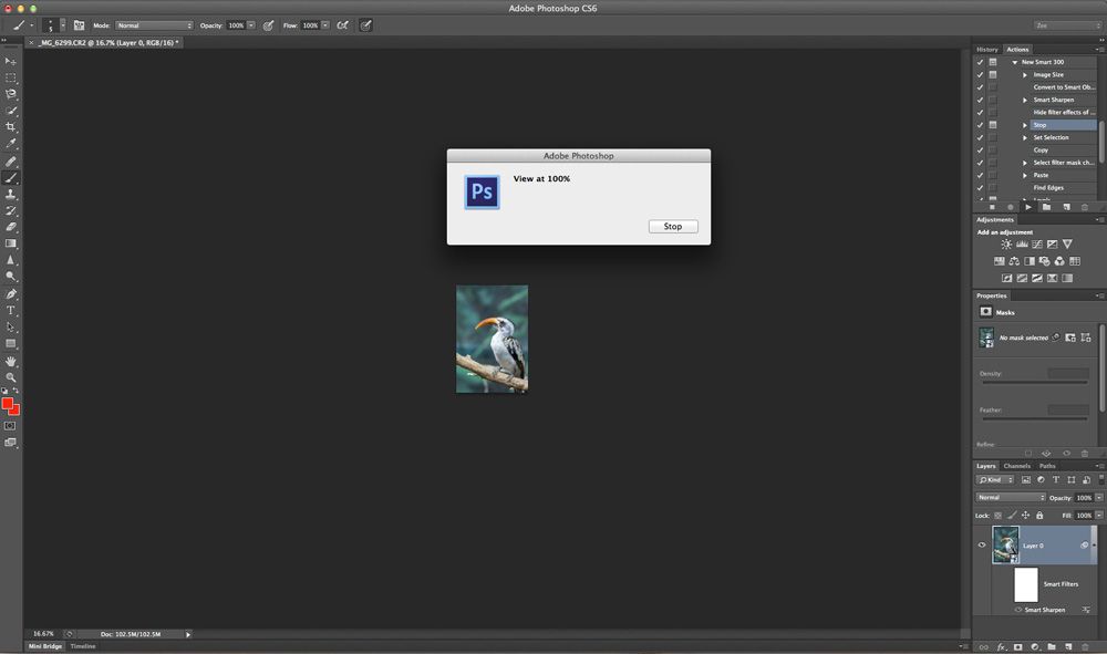

3. The Action stops and reminds me to view at 100%. Press stop and then view 100%
IMAGE: http://i33.photobucket.com/albums/d74/Zenon1/New%20RSS/Image-3_zps17eea5ba.jpg
4. Press Play again

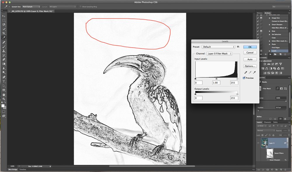

5. Now the mask comes up. Notice all the light grey in the background. That will be sharpened as well and will sharpen any existing noise.
IMAGE: http://i33.photobucket.com/albums/d74/Zenon1/New%20RSS/Image-5_zps81772d91.jpg

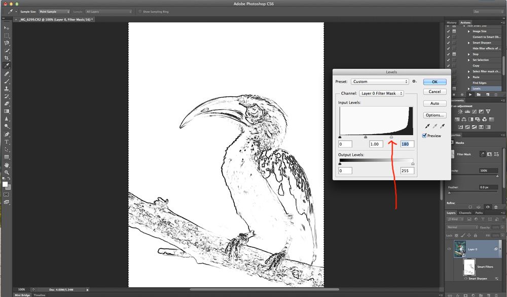

6. Use the input level slider to taste to clean up what areas will be sharpened. Notice how much less will be sharpened in the beak as well. I pay attention to skin tones of people and around the eyes, etc. I try to keep skin tones pure white.
IMAGE: http://i33.photobucket.com/albums/d74/Zenon1/New%20RSS/Image-6_zps39d822d6.jpg

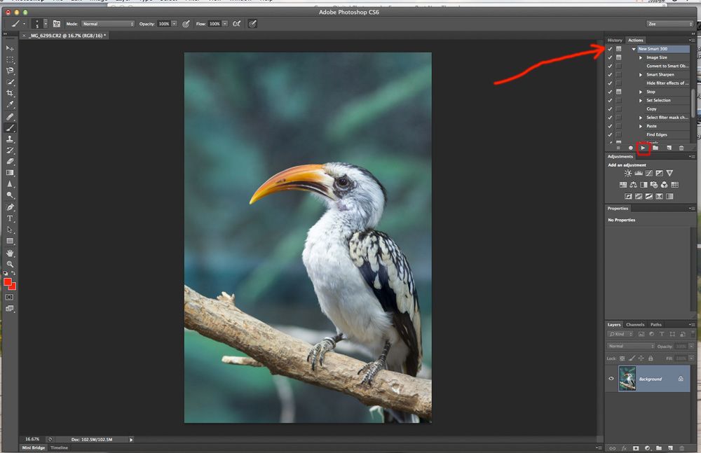

7. Press OK and the final over sharpened product will appear. Use the Feather slider and cool to taste. When done flatten the layer.
IMAGE: http://i33.photobucket.com/albums/d74/Zenon1/New%20RSS/Image-7_zpsdabfa0ac.jpg
Here is my action if you are interested. There is a second one called New Smart 200. The Smart Sharpening is Amount = 200 if you want less aggressive sharpening but I rarely use it.
