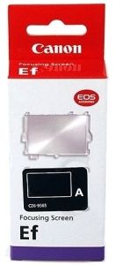

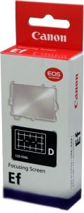

Apr 27, 2014 07:13 |  #7
Maybe someone else changed the focus screen before you bought it? Did you buy the camera new or used?
Ef-A Standard Precision Matte
- the supplied focusing screen, bright and with a normal matte
Ef-D Precision Matte with grid
- a more matte finish easier manual focusing also includes a grid pattern
Ef-S Super Precision Matte
- even more matte but obviously slightly darker, optimized for F2.8 and faster lenses
IMAGE: http://i2.photobucket.com/albums/y17/msowsun/photo%20stuff/Photo15/_EF_A.jpg~original
IMAGE: http://i2.photobucket.com/albums/y17/msowsun/photo%20stuff/Photo15/_EF_D.jpg~original
IMAGE: http://i2.photobucket.com/albums/y17/msowsun/photo%20stuff/Photo15/_EF_S.jpg~original
