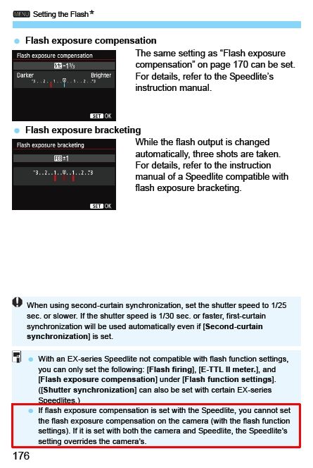

Make sure your FEC is set at "0" on the flash itself, and then set the FEC on the camera. Any FEC setting on the flash will over-ride the camera. Read the note at the bottom.
IMAGE: http://i2.photobucket.com/albums/y17/msowsun/photo%20stuff/Photo15/_6d_flash.jpg~original
Looks like I was good there as well. Would the fact that I was bouncing the flash make any difference?

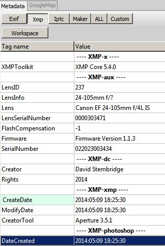

I still don't understand your actual problem.
Are you able to adjust the FEC in the camera menu? In the photo you posted the "XMP" EXIF data shows -1 FEC. I am not familiar with XMP data. Does that mean it was done in Post Processing?
IMAGE: http://i2.photobucket.com/albums/y17/msowsun/photo%20stuff/Photo15/_6da.jpg~original
photo with EXIF data intact
IMAGE: http://i2.photobucket.com/albums/y17/msowsun/photo%20stuff/Photo15/001.jpg~original
