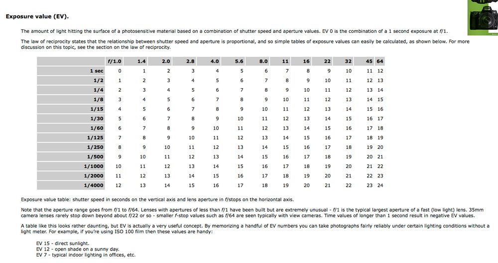

First off, sorry if this is in the wrong section. Mods may move at their discretion. Second, I am sure this has been hashed and rehashed on this forum and I regret that I didn't do my due diligence and search. But...
Am I understanding this correctly?
Let's say I am in P mode on my camera and ISO 100. The camera meters the scene and chooses to use F5.6 and 1/30 as it's aperture and shutter speed. Based on the attached chart, that gives an EV value of 10.
If I switch to M mode, will I then be able to go across the entire EV 10 range values and get the "same" exposure?
F1.4 & 1/500 to F22 & 1/2 if my lens has a max aperture of 1.4 and a min of F22?
If this is correct, then when I change my ISO from 100 to 200, or one stop, my EV would go to 11 and my exposure range would be F1.4 & 1/1000 to F22 & 1/4?
Thanks!
Chart can be viewed from here (external link) and it's located all the way at the bottom...

Moonshiner wrote in post #16948617 (external link)
Yes
Yes
No. In the same amount of light, the EV value is unchanged, regardless of ISO value. However, that chart does publish EV as if it refers to an illumination level at ISO 100. So rather than f/1.4 with 1/1000 at ISO 100, you would use [f/2 with 1/1000, or use f/1.4 with f/2000] at ISO 200.

Wilt wrote in post #16948778 (external link)
Ahh... I see... That makes sense... Thanks!
I don't think that on this forum "due diligence" would have yielded much, because that article and the charts he shows have some viewpoints that would be alien to most of us! For example, we (at list in our discussions) don't have a list of EV numbers from 1-10. For most of us, EV is about a couple things:
First, in the practical world, EV denotes the level of exposure you get from the combination of aperture, shutter speed and ISO. If you set those to what the camera considers "normal", such as your P-mode or another auto mode if don't apply any Exposure Compensation, then we typically refer to that as EV 0. If you do either apply some exposure compensation or change one of those three settings, then you change your EV, so if, for example, your camera is metering a scene/subject and giving 1/100 sec, f/4 @ ISO 100, then if you shoot with those settings, the meter/exposure is at "EV 0". But for many of us, we don't want that exposure, we want to either boost the exposure higher or lower, so we use one of the above approaches to do that, so say if you adjust your settings to 1/50 sec, f/4 @ ISO 100, you are doubling the amount of light taken in, meaning that according to the camera meter, you are pushing the exposure up to EV +1 (or +1 EV).
I'm putting this in these practical hands-on terms, because, well, most of us have likely not studied something like the article/charts you linked to, and our discussions will me more "hands-on":)!
The second "scenario" in which it might come up is in the context of camera specs, regarding the "Metering Range" of a camera as it relates to the AF function, where it will give the range of a camera's effective metering in EV values. So, if you read the Specifications in your camera manual you'd come across that term! It has, though, to do with the ambient light, not your camera settings, although I don't have the expertise/understandin​g to delve into that topic!

Guys,
EV is the quantification of the intensity of light falling on a scene. It has no ISO. It is an ABSOLUTE measure of the amount of light.
Light meters of old used to have an EV display. I still have one... It tells me something like EV10, and that value has no direct correlation to exposure until I [choose an ISO which then results in the shutter+aperture combinations (many of them)]!
Even modern meters have the EV display, but these assume ISO 100 correlation still. I have an Illuminance lable on the back of my Minolta Autometer Vf which says "EV0 = 0.31 footcandles of light, for the spherical diffuser, ISO =100, and C=31".
Have you notice that specs show, for the Canon 1D3 Mark III, "Metering range: 0 - 20 EV". That specifies the minimum level of light (and the maximum) which the camera's meter can respond to.
The EV charts like the one posted by digital paradise ASSUMES [a combination of f/stop and shutter speed which is based upon ISO 100 sensitivity] to the light. And uses of EV in a RELATIVE measure, such as what tonylong mentioned, allow us to give delta values from some arbitrary reference exposure. But fundamentally, EV is a fixed level of light (like the minimum amount of light that a meter can measure), but it also happens to be spoken of in a relative sense as well (+2EV, -1EV, etc.)

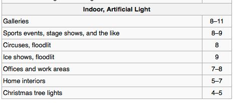

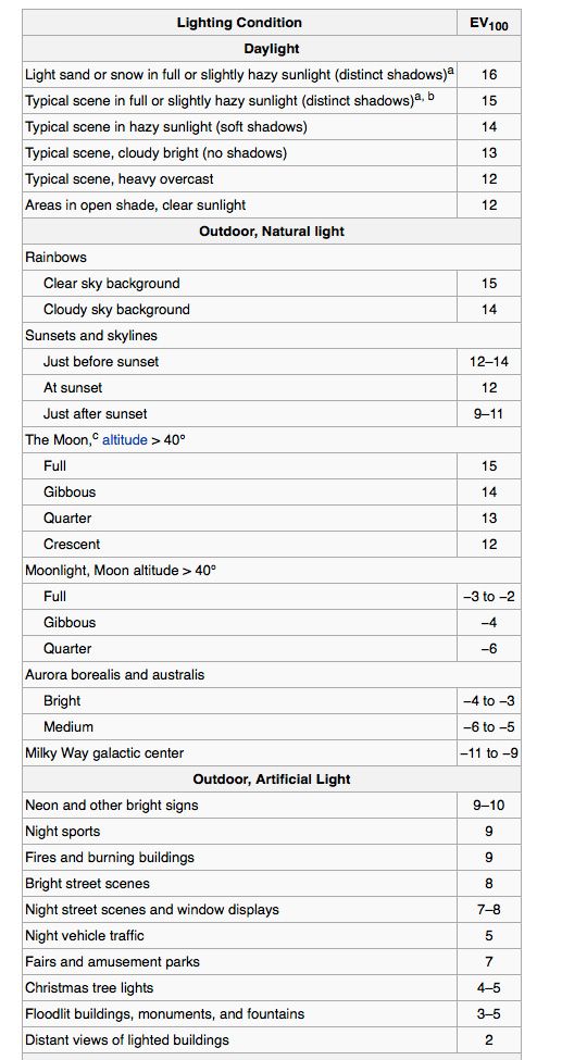

Not sure thus will help any.
IMAGE: http://i33.photobucket.com/albums/d74/Zenon1/Technical%20Fash/EV1_zps06cf29f7.jpg
part 2
IMAGE: http://i33.photobucket.com/albums/d74/Zenon1/Technical%20Fash/EV2_zps90aa74f2.jpg
Image Editing OK
