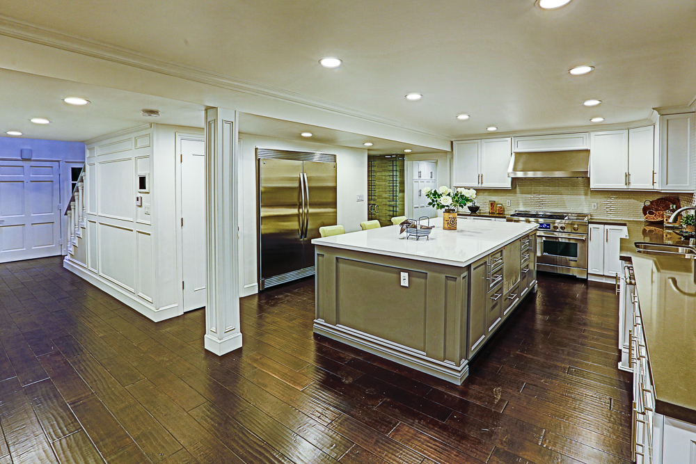

I think the biggest problem with davids style of shooting is actually getting paid for THAT amount of work. In Los angeles, where everyone is flip crazy, realtors are pretty stingy with the cash. I could see your work going into architectural magazines though.

In camera HDR with a 5D3 OR 6D and perspective corrected in Lightroom (whitebalance needs to be corrected for almost every shot). No FLash, Tilt shift lens or image blending in photoshop. Not as good obviously, but a great technique if you are starting out and need to pay the bills. I can typically cover a house in 1 hour and upload the images in 30 minutes. Realtors have been very happy with this style of photography and homes sell quick. 16mm 1/3 is200 F9
IMAGE: http://www.sfvphoto.com/wp-content/uploads/2014/05/5D3_9502.jpg
