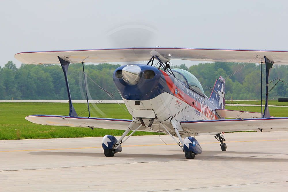

Various prop blur examples with EXIF. There's no single or simple shutter speed for every prop blur circumstance.
IMAGE: http://i1174.photobucket.com/albums/r601/kevinlillard/07092014b/20110513a2608_zps0603f6fb.jpg
Camera Maker: Canon
Camera Model: Canon EOS REBEL T2i
Lens: 150-500mm
Image Date: 2011-05-13 14:06:16 (no TZ)
Focal Length: 150.0mm
Aperture: f/16.0
Exposure Time: 0.010 s (1/100)
ISO equiv: 100
Exposure Bias: none
Metering Mode: Matrix
Exposure: shutter priority (semi-auto)
White Balance: Auto
Flash Fired: No (enforced)
Orientation: Normal
Color Space: sRGB

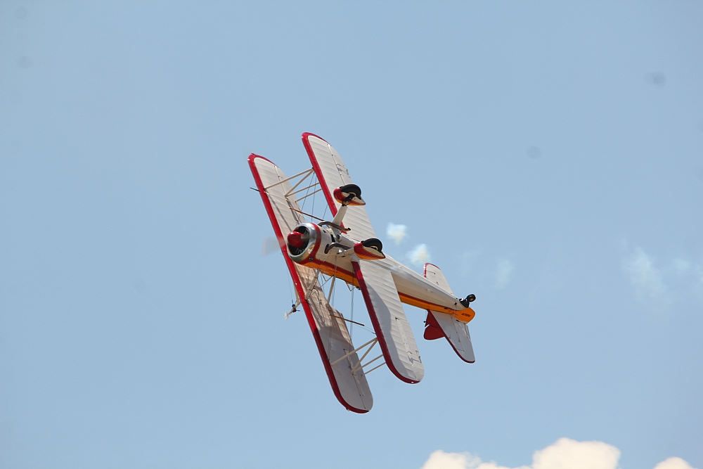

IMAGE: http://i1174.photobucket.com/albums/r601/kevinlillard/07092014b/20120622a1831a_zpsaa0ae260.jpg
Camera Maker: Canon
Lens: 150-500mm
Image Date: 2012-06-22 13:35:18 (no TZ)
Focal Length: 403.0mm
Aperture: f/9.0
Exposure Time: 0.0020 s (1/500)
ISO equiv: 200
Exposure Bias: +1.33 EV
Metering Mode: Partial
Exposure: program (Auto)
White Balance: Auto
Orientation: Normal
Color Space: sRGB

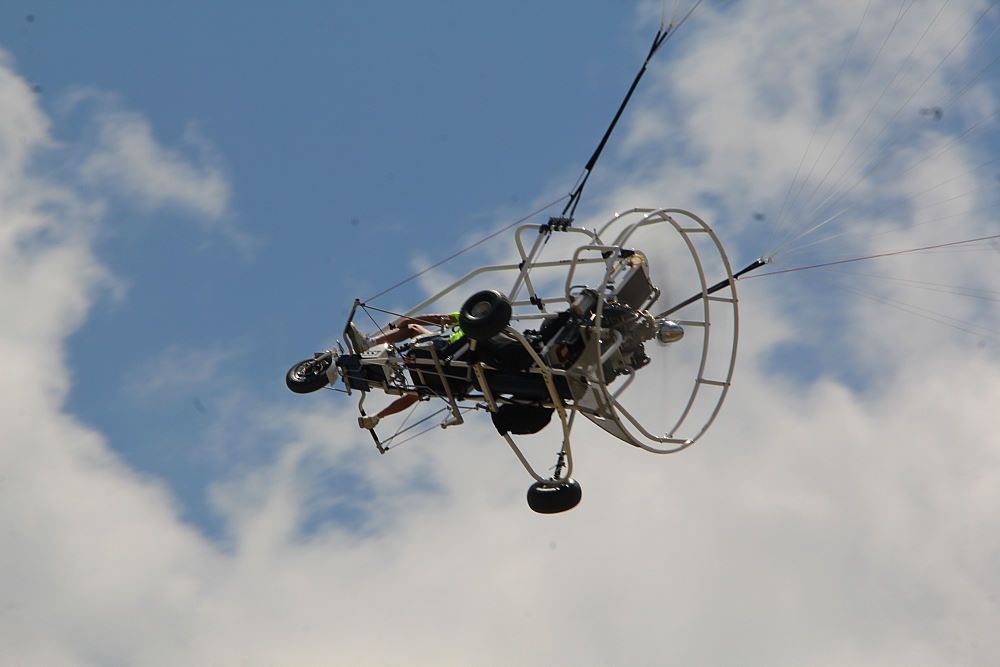

IMAGE: http://i1174.photobucket.com/albums/r601/kevinlillard/07092014b/20120622a0578a_zpsd10012ac.jpg
Camera Maker: Canon
Lens: 150-500mm
Image Date: 2012-06-22 12:35:31 (no TZ)
Focal Length: 500.0mm
Aperture: f/20.0
Exposure Time: 0.0080 s (1/125)
ISO equiv: 100
Exposure Bias: none
White Balance: Auto
Orientation: Normal
Color Space: sRGB
IMAGE: http://i1174.photobucket.com/albums/r601/kevinlillard/07092014b/20120729b0007_zps48744250.jpg
Camera Maker: Canon
Camera Model: Canon EOS 60D
Lens: 150-500mm
Image Date: 2012-07-29 13:07:10 (no TZ)
Focal Length: 289.0mm
Aperture: f/14.0
Exposure Time: 0.0063 s (1/160)
ISO equiv: 100
Exposure Bias: none
White Balance: Manual
Orientation: Normal
Color Space: sRGB
Most propeller-driven aircraft use constant-speed propellers. One rule of thumb is that the smaller the propeller, the faster the rotating speed.
The large propellers/rotors on the V-22 Osprey shown rotate slower than they seem to the naked eye, and there's less prop blur at 1/160 with an Osprey than with a Stearman's radial engine at 1/500.
These examples were generated from a Sigma 150-500mm optical stabilizer lens, a heavy unit. the lens was used handheld in these examples, but it took around a month to get used to the lens' mass.
