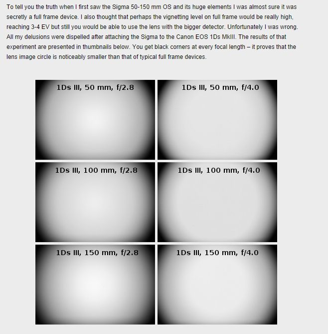

Jul 20, 2014 07:07 |  #9
Here is an example where the Sigma APS-C 50-150mm vignettes badly at ALL focal lengths on FF.
http://www.lenstip.com …DC_OS_HSM_Vigne​tting.html (external link)
VVVVVVVVVVVVVVV
IMAGE: http://i2.photobucket.com/albums/y17/msowsun/photo%20stuff/Photo15/50-150.jpg~original
