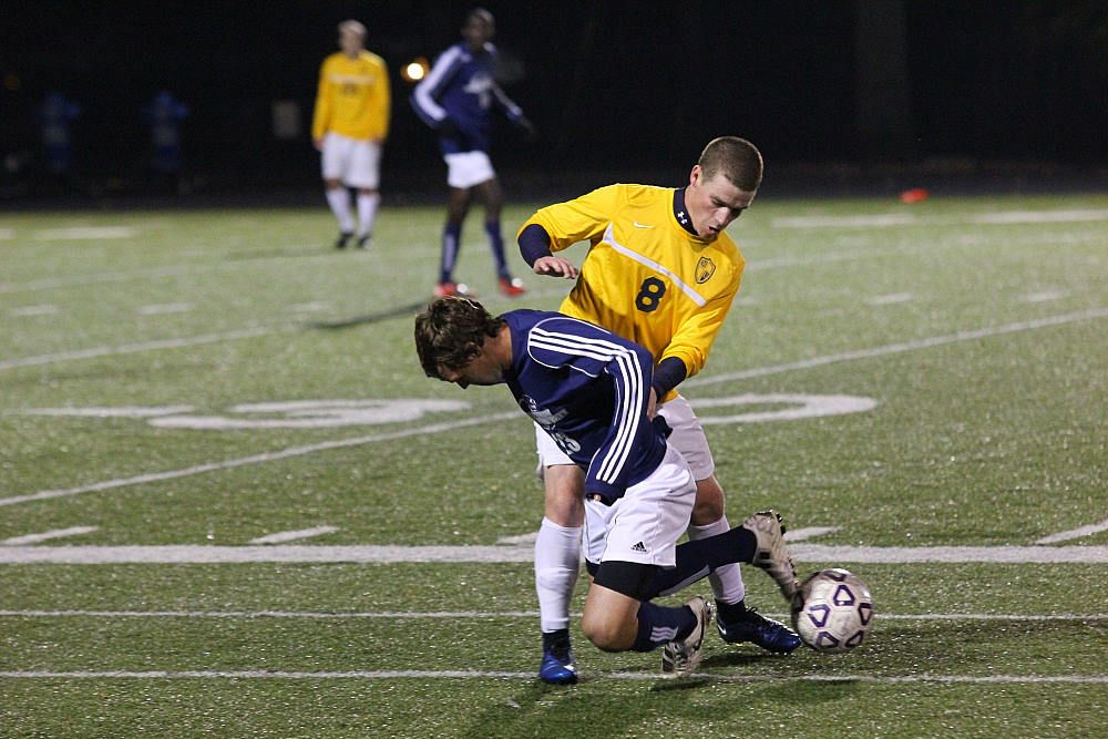

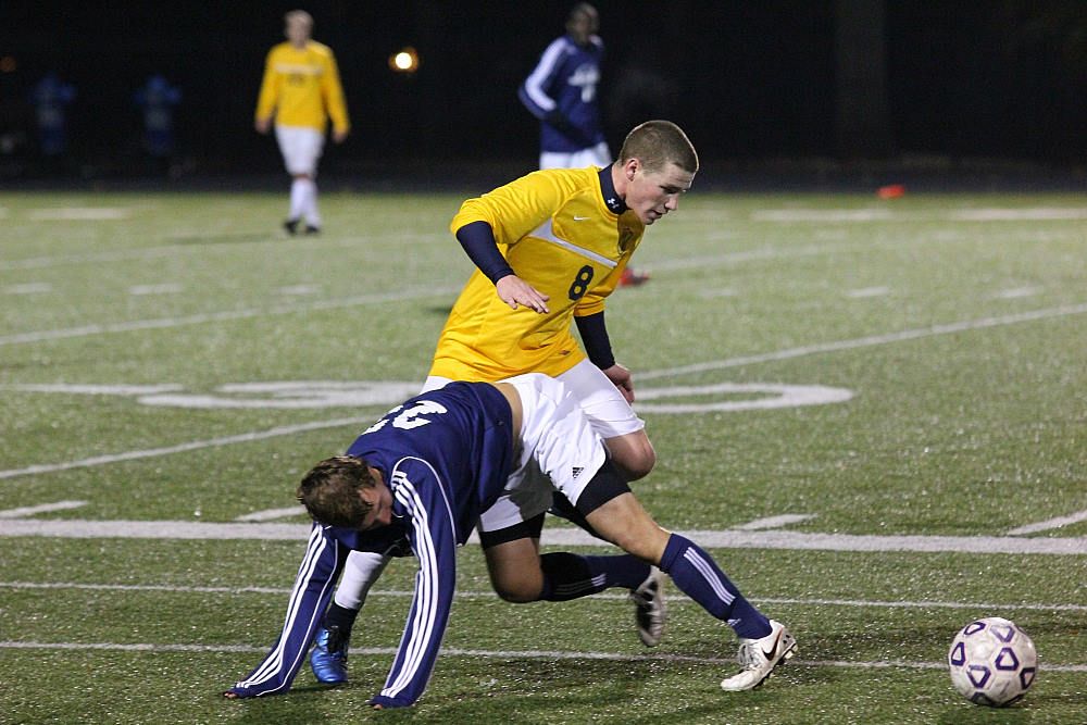

GeoKras1989 wrote in post #17082128 (external link)
Really? I shoot mine at 6400 with frame-able results. So do lots of other folks. Perhaps a gander at the 'high-ISO' thread is warranted? To be sure, at that level, proper exposure and post-processing are essential. The camera is quite capable; any ISO limitations imposed on the 60D come from the shooter.
High ISO night football from a 70-200mm f/2.8 lens and a Canon T2i, the 60D's stablemate.
IMAGE: http://i1174.photobucket.com/albums/r601/kevinlillard/08072014a/20111018a0000b_zps9ce368ed.jpg
Camera Maker: Canon
Camera Model: Canon EOS REBEL T2i
Lens: 70-200mm
Image Date: 2011-10-18 20:13:51 (no TZ)
Focal Length: 144.0mm
Aperture: f/4.0
Exposure Time: 0.0025 s (1/400)
ISO equiv: 5000
Exposure Bias: none
Metering Mode: Matrix
Exposure: Manual
Exposure Mode: Manual
White Balance: Auto
Flash Fired: No (enforced)
Orientation: Normal
Color Space: sRGB
IMAGE: http://i1174.photobucket.com/albums/r601/kevinlillard/08072014a/20111018a0860_zps1e638d4a.jpg
Camera Maker: Canon
Lens: 70-200mm
Aperture: f/4.0
ISO equiv: 5000
Exposure Bias: none
Exposure: Manual
White Balance: Auto
Orientation: Normal
Color Space: sRGB
Not even any noise reduction this time.
On another point, a 70-200mm lens' focal length limits its usefulness with football. As in these examples, you need to wait for action to reach a frame-filling distance for useful images, something that's not guaranteed when play is mostly in the far end.
