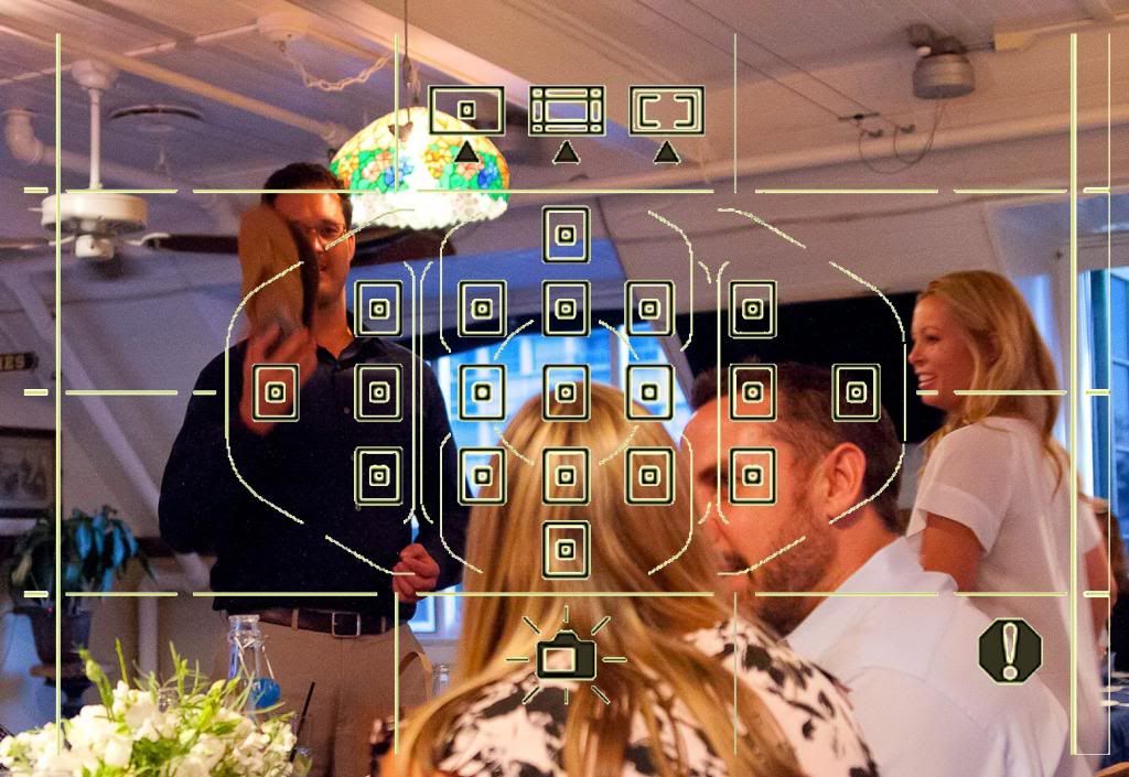

I dare say that most folks do some shifting of the frame before shooting, unless they often commit the sin of bullseye'ing their subject and/or they simply never adjust framing for best composition! Oftentimes our point of focus can be on very small items that do not fall exactly on an AF point, so when we choose the 'closest AF point' to focus we end up with some subtle adjustment in framing...even if we shift a degree or two , we do NOT necessarily aim precisely at the same point in the scene when we are taking 4-5 shots in succession! The chosen AF zone can suddenly be seeing air next to the real aim point when the shutter is pressed!
In this photo, the bride (blonde on the right) is perhaps my desired subject of interest, yet I cannot frame her to be at the AF point furtherst to the right!

Wilt
46,453 posts
Likes: 4545
Location: Belmont, CA
Aug 20, 2014 10:07 |  #20
MedicinSC wrote in post #17107316 (external link)
It depends on how many points you have. My 7D has 19 points..
I took the viewfinder of the 70D and superimposed it over an image which I took with my ancient 40D (pardon the poor quality, I chose it to provide example of frame content vs. AF point availability, in my post 18.

Aug 20, 2014 18:44 |  #22
Wilt wrote in post #17107346 (external link)
But, if you took a step to the right, you could cover her with the extreme right focus point. You'd still have everybody in your image. I'm not at all saying that what I do is better, just that it's better for me. I figure out what I want my composition to be, I view, through the camera and frame, activate the metering system so my active point is displayed, use the joystick to move to whichever point I need, slightly recompose my image if a point doesn't quite match up (by moving my subject if possible, or by moving myself), and then engage the focus mechanism. It sounds like a lot when writing it out, but in practice it takes only a few seconds.

Aug 21, 2014 11:17 |  #24
MedicinSC wrote in post #17108297 (external link)
But, if you took a step to the right, you could cover her with the extreme right focus point. You'd still have everybody in your image. .
The center of action was the groom, although my main interest was in the bride's reaction to his antics. That gave me what I wanted to capture.
To put the bride at the AF point while moving the groom to the edge of the shot would fail to position well the reason for her reactions (the groom)! So one had to AF on her, shift frame slightly so the AF point is now on empty space (and thereby voiding the value of AF point display!) I'm not arguing against your methodology, I am saying that it simply does not always permit the photographer to accomplish what he wants.
