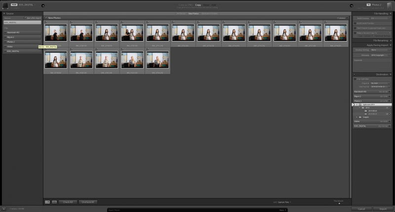

Trying to import files from my SD card from a job earlier today. The other day, I ran out of room on the drive I was using so I added another drive and imported files to that drive. Now, when I try to import to the drive, it's telling me I don't have enough room on the original drive I used--NOT the new one. It's telling me this even though I have the target pointing to the NEW drive.
Cannot figure out why this is happening. I've added drives many times in the past with no issues. I don't know of anywhere else I need to point it to, besides, it imported just fine when I first added the disk.
Help!

Can you pop up a screen grab
Here's a shot:
IMAGE: http://i128.photobucket.com/albums/p199/GadgetRick/Temp/ScreenShot2014-08-25at32117PM.png
Bigun-2 was the original drive. Photos 2 is the new drive.

Unplug the original drive and restart lightroom - is your catalogue on the original drive? Your 1:1 preview location is it the same as your catalogue?

Aug 25, 2014 16:31 |  #12
You said you old drive is full, if you make space on it by moving some files to your new drive you are allowing room for Lightroom to write the information into its catalogue and it's previews folders.
These are the folders that Lightroom 5 uses to store information about your photos and the changes you make to them including location;
Catalog: [catalog name].lrcat
Previews: [catalog name] Previews.lrdata
Smart Previews (Lightroom 5 only): [catalog name] Smart Previews.lrdata
Use your finder to check the size of them, they can get quite large. In essence the drive that has your catalogue on it will need space for Lightroom to run it's import, even if you send the image files to a different hard drive.

Aug 25, 2014 16:50 |  #13
Two Hot Shoes wrote in post #17117253 (external link)
I was messing around and now I understand what you're getting at. I've moved the catalogs I was using over to the new drive. Yes they're large but small enough to do this. I guess the last import put the catalogs over the edge. I hadn't realized it was storing the previews along with the catalog, I had thought they were stored with the photos.
Thanks for the help!
