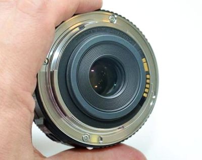

Nov 22, 2014 19:21 |  #156
GeoffSFAs10 wrote in post #17287554 (external link)
Thats what im thinking. That'd be a pretty stellar lens for a FF i'd think.
The EF-S 24mm STM has a metal mount, and just like the EF-S 10-22mm, you should be able to pop out the the plastic/rubber piece and mount it on a FF camera.
BUT....
1) The image circle will be smaller and will probably have serious vignetting with dark corners if used on a FF camera.
2) The rear lens element moves backwards as you focus to infinity and I suspect it will contact the larger mirror on a FF camera.

I didnt realize the 24 had a metal mount. i thought it was plastic in the all the photos I had seen of it.

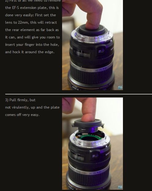

msowsun wrote in post #17287799 (external link)
Have you tried? My 18-135 STM has a baffle that pops out easily using one finger...
The lens is totally useless on FF as it vignettes badly at all focal lengths just like my 15-85 USM did.
yeah, i tried...what's supposed to pop out? that whole circular area, right? mine doesn't budge

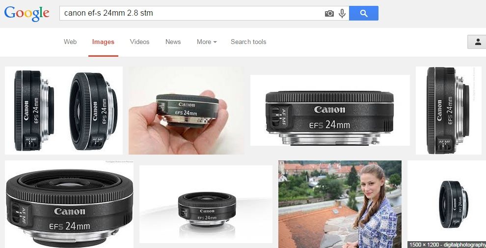

GeoffSFAs10 wrote in post #17287733 (external link)
Every photo I have seen shows a metal mount.
https://www.google.ca …AT0_YGwCg&ved=0​CAYQ_AUoAQ (external link)

strike my last post...i guess i just didn't pull hard enough...also pro tip...it helps to zoom the lens out :)

DreDaze wrote in post #17287807 (external link)
Yes, the whole circular plastic area pops out. You do have to pull pretty hard. Just like the 10-22mm.
http://sorenjohansen.w​ordpress.com …g-the-canon-10-22mm-lens/ (external link)
