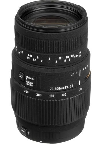

We are frequent air travellers and after a recent flight in a small plane in Africa realised the tele lens is blurry, especially at the edges, and can`t focus clearly. I use a Canon 600D and Sigma 70-300mm tele lens (which has been stored in a lined plastic container with lids to close). The 18-55mm Canon lens that has been sitting on the camera doesn`t seem to be affected.
I wonder what happened to the Sigma. I had it for 2 years, but only used it on 3 trips really. I assume it has to do with the lack of cabin air pressurisation in the small propeller plane and maybe the high quality Canon lens handled it better. Anyone heard of that, any ideas?
I want to replace the broken Sigma (quality was good for the price but not brilliant) with a Canon 55-250mm IS. Is there a better way to store the equipment during flights? Is there something like airtight containers for cameras?
It may have nothing to do with the trip. It could have just been "It's Time" to fail.
You say you have only used it a few times. It could it be that there is nothing wrong with the lens and it is just user error. Telephoto lenses have slower apertures and need much faster shutter speeds than normal focal length lenses. This is especially true since the Sigma 70-300mm does not have Image Stabilization.
Your EXIF data says it was taken at 70mm wide open using an f/4.5 aperture and with a 1/125 shutter seed. Even at 70mm 1/125 may not be a fast enough shutter speed for hand holding. At 300mm you should use about 1/500 as a minimum to prevent camera shake.
Did you get any good photos at all from this lens? To further trouble shoot I would remove any filters and shoot with a tripod or higher ISO to eliminate the possibility of camera shake. I would also try manual focus using Liveview, or use Liveview Auto Focus, and shoot with the lens stopped down at f/8 or f/11.
Is this the lens you have? Is there any chance you have it in "Macro" Mode?

Yep, that`s the lens. No, the Macro Mode is not on - I made sure that`s all ok before I started to believe something must be seriously wrong with it. But it`s a good point, the little switch is a bit touchy. Thanks for your thoughts :)
