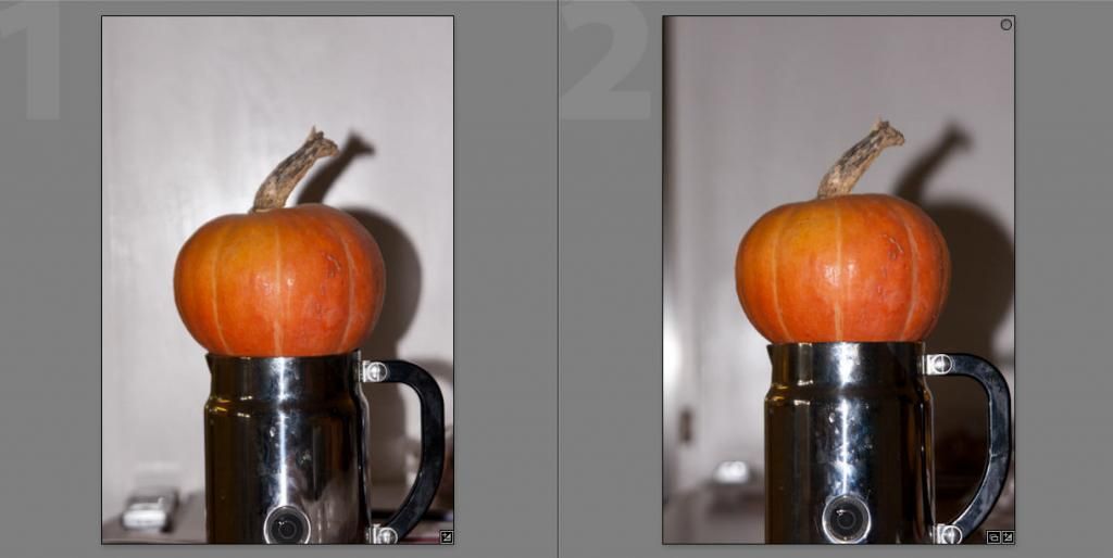

gonzogolf wrote in post #17223844 (external link)
Unless you raise the light source even moving the subject farther from the wall won't help much. The side flash from a near axis will project shadowing onto a wall more than 10ft behind the subject.
Illustrating the futility of moving subject away from background...
IMAGE: http://i69.photobucket.com/albums/i63/wiltonw/Principles/flashangledistance_zpsd07caab8.jpg
The shot on the left is with subject very close to background, the shot on the right is with subject-to-background distance increased by about 2x...note the shadow merely becomes MORE prominent with greater subject-to-background distance, in this case about 2x as far out to the side (since the subject-to-background distance was doubled)!!!
The way to get the shadow out of the picture is to either
  • Move the light source farther from the camera, so shadow falls outside the AOV captured by the frame, or
  • Move the light UP OVER the lens axis, so the shadow falls down behind the subject -- which hides the shadow from the lens!
