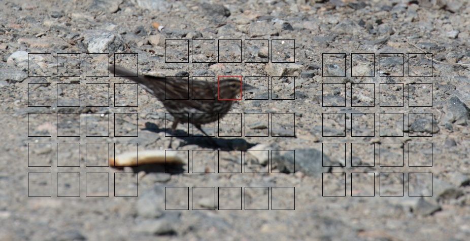

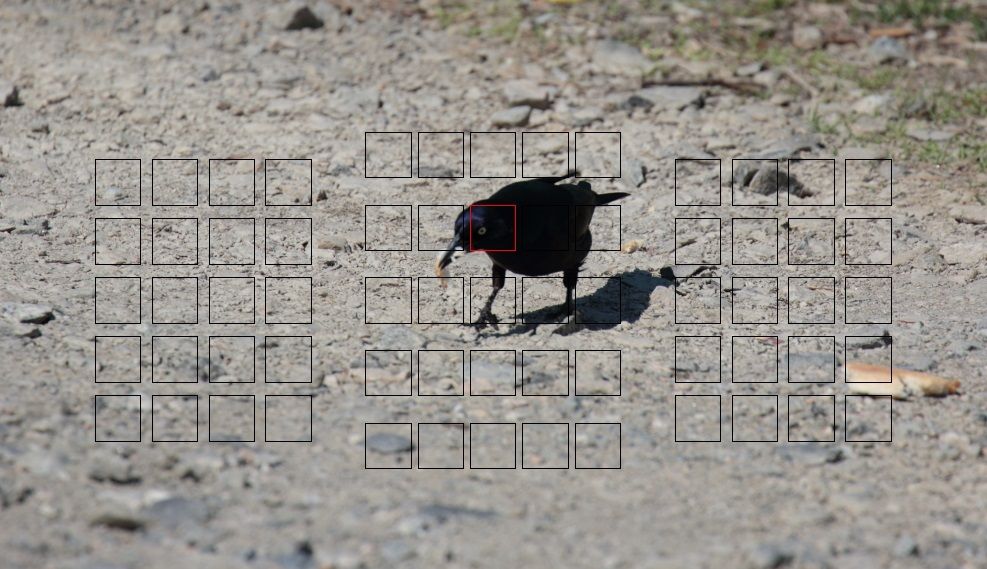

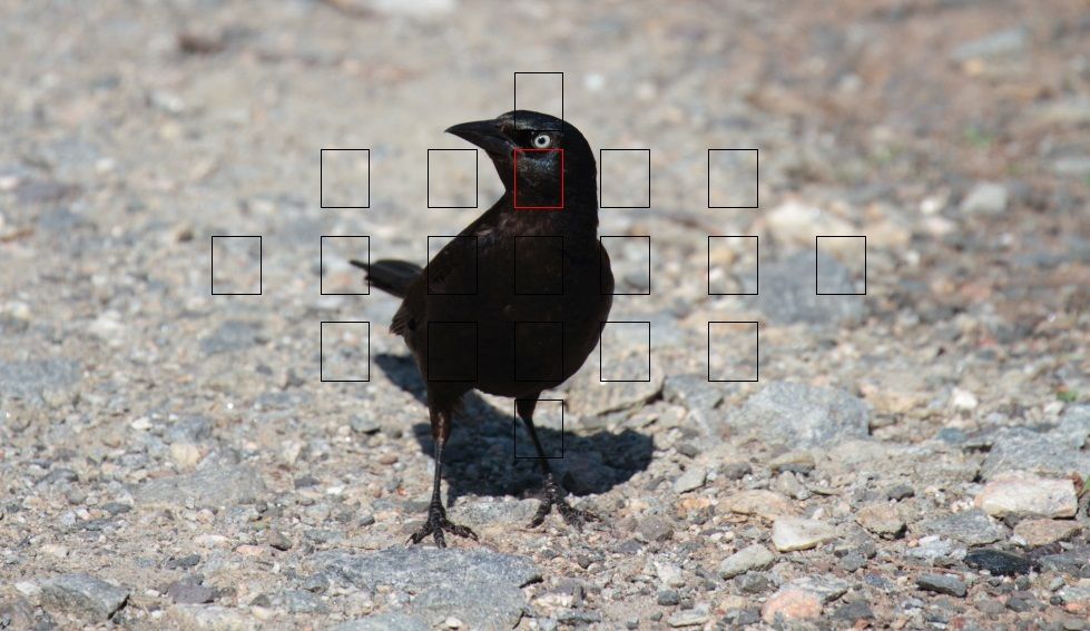

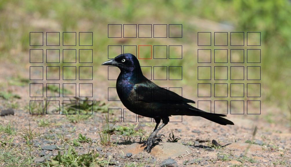

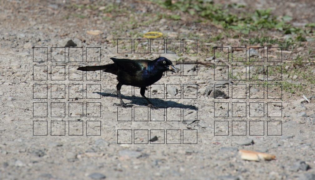

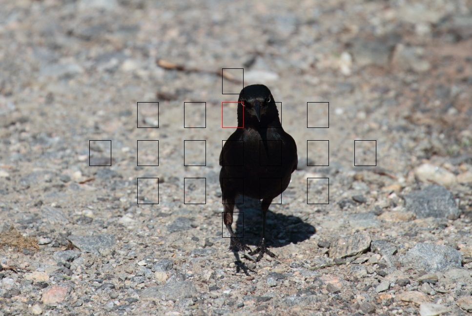

Need some help/advice I took my 7d and 7D Mark II (3rd body) out today I wanted to see how they compared I've been experiencing some issues with it not wanting to focus or loosing focus. I set both cameras to relatively the same settings Tv mode Shutter Speed 1/1250 Av 5.6, Auto ISO ( it was around 106 or so on most shots)and I used the same lens(EF 70-300mm f/4-5.6L IS USM Lens)what I found was the 7D seemed to focus faster and stay focused as I tracked the subject or it moved. I'm not sure but it seems like the 7D Mark II randomly back,front focuses then its right on target. I did the MFA on the 7D Mark II but not the 7D. I'm not saying all the shots from the 7D were perfect maybe 85% keepers (233 shots) the example below was pretty consistent. The 7D Mark II also had some decent shots not all were bad about 40% keepers(236shots) when the AF decides it wants to work it works good. Here are a few examples (these are screen caps from the unedited raw shots) all shots were take at roughly the same distance.
Thanks
John
These were taken with the 7D Mark II
IMAGE: http://i1237.photobucket.com/albums/ff461/JM45ACP/mk2focus%20point2_zpschsovrl5.jpg
IMAGE LINK: http://i1237.photobuck​et.com …%20point2_zpsch​sovrl5.jpg  (external link) on photobucket
IMAGE: http://i1237.photobucket.com/albums/ff461/JM45ACP/mk2focus%20point4_zps4etlcg1c.jpg
IMAGE LINK: http://i1237.photobuck​et.com …%20point4_zps4e​tlcg1c.jpg  (external link) on photobucket
No focus point selected
IMAGE: http://i1237.photobucket.com/albums/ff461/JM45ACP/mk2focus%20point3_zpsckhlgjym.jpg
IMAGE LINK: http://i1237.photobuck​et.com …%20point3_zpsck​hlgjym.jpg  (external link) on photobucket
Focal point isn't on the head but it looks ok
IMAGE: http://i1237.photobucket.com/albums/ff461/JM45ACP/mk2focus%20point1_zpsg5j2sdgz.jpg
IMAGE LINK: http://i1237.photobuck​et.com …%20point1_zpsg5​j2sdgz.jpg  (external link) on photobucket
IMAGE: http://i1237.photobucket.com/albums/ff461/JM45ACP/7Dfocus%20point1_zpsy1kwa7vi.jpg
IMAGE LINK: http://i1237.photobuck​et.com …%20point1_zpsy1​kwa7vi.jpg  (external link) on photobucket
IMAGE: http://i1237.photobucket.com/albums/ff461/JM45ACP/7Dfocus%20point2_zpsxnklyjki.jpg
IMAGE LINK: http://i1237.photobuck​et.com …%20point2_zpsxn​klyjki.jpg  (external link) on photobucket
5D MARK IV== 7D Mark II==7D == EF 24-105mm f4L IS USM == EF 100mm f/2.8LMacro==70-200mm f2.8L IS II USM == EF 70-300mm f/4-5.6L IS USM UD == EF 100-400mm f/4.5-5.6L IS II USM==Speedlite 430 EX II PHOTO EDITING OK
LonelyBoy
1,482 posts
Gallery: 84 photos
Likes: 1004
Joined Oct 2014
May 24, 2015 16:57 as a reply to  @ JM45ACP's post |  #2704
Both of those 7D shots look front-focused to me (but not horribly). That first one would have me wanting to throw my camera into the rocks, though. :(
https://www.flickr.com​/photos/127590681@N03/ (external link)
I love a like, but feedback (including CC) is even better!
mnphotos
759 posts
Likes: 26
Joined Aug 2012
Location: Arizona
May 24, 2015 17:19 as a reply to  @ JM45ACP's post |  #2705
Have you updated the firmware on the 7D MKII yet?
JM45ACP
715 posts
Gallery: 50 photos
Likes: 639
Joined Dec 2011
Location: Ct. USA
May 24, 2015 17:24 as a reply to  @ mnphotos's post |  #2706
It's very frustrating
Yes firmware is updated
wallstreetoneil
2,086 posts
Gallery: 14 photos
Likes: 1219
Joined Nov 2014
Location: Toronto Canada
May 24, 2015 17:46 |  #2707
can you give us some more details on how you set up the camera
- AI Servo, Single shoot
- BBF y/n
- which focus points used?
- IS on or off as you are tracking birds
- etc, etc, etc
Hockey and wedding photographer. Favourite camera / lens combos: a 1DX II with a Tamron 45 1.8 VC, an A7Rii with a Canon 24-70F2.8L II, and a 5DSR with a Tamron 85 1.8 VC. Every lens I own I strongly recommend [Canon (35Lii, 100L Macro, 24-70F2.8ii, 70-200F2.8ii, 100-400Lii), Tamron (45 1.8, 85 1.8), Sigma 24-105]. If there are better lenses out there let me know because I haven't found them.
JM45ACP
715 posts
Gallery: 50 photos
Likes: 639
Joined Dec 2011
Location: Ct. USA
Post edited over 8 years ago by JM45ACP.
May 24, 2015 18:49 |  #2708
Here are the settings on the camera.
BBF on shutter button set to metering
Focus Points: Expanded AF 9 points (I have tried all of them at one time or another)
AI servo
evaluate metering
low speed continuous 7 fps
ISO Auto
AWB
Case 1 (the camera AF acts the same regardless of the case its in)
AI servo 1st and 2nd image priority both set to Focus
Latest Firmware 1.0.4
Thanks
John
Canon-Chas
243 posts
Gallery: 17 photos
Likes: 115
Location: Scotland
Post edited over 8 years ago by Canon-Chas. (2 edits in all)
May 25, 2015 03:53 |  #2709
JM45ACP wrote in post #17569637 (external link)
AI servo
evaluate metering
ISO Auto
AWB
Thanks
John
Personally I would always use single point focus, Single shot AF Mode or AI Focus and a high enough shutter speed to freeze any movement. I know some folks insist on using AI Servo all the time for moving subjects which is correct, but a bird on the ground is hardly moving and AI Servo isn't appropriate in this case. If your shutter speed is correct and your focus point selection is correct you should nail these shots without difficulty. I can only speak for myself but I have rarely failed to nail a bird on the deck using the above settings. The small brown bird in the first image is poorly contrasted with the background which doesn't help the camera. AI Servo is for action shots , and I wouldn't class this as action photography
This is just my opinion John, but it works for me anyway, hope this helps ;-)a
Chas
http://www.wildfeather​s.co.uk (external link)
buddy4344
OM System Ambassador
1,693 posts
Gallery: 412 photos
Best ofs: 14
Likes: 2174
Location: Allentown, PA
Post edited over 8 years ago by buddy4344.
May 25, 2015 04:46 |  #2710
John,
A couple of thoughts:
First, BBF is the invention of the devil when it comes to birds walking or jumping limb to limb. I lead photo workshops in Africa and invariably, there is a beginner (I'm not talking of you) that has read about BBF from Art Morris and feels it is magic. Unfortunately, they forget to refocus once the animal or bird moves. When the subject is as close as your example, a simple tilt of body angle is all it takes to put the body out of focus. In your first two images, the focus point is clearly behind the bird, so this could have been your issue.
Second, the birds look VERY CLOSE. It looks like the bird may have been inside your minimum focus range setting. Another very common mistake.
I know the bird looks bigger in frame on the last two vs the first two with 7D MkII. Was it the exact same lens with exact same settings?
Also regarding MFA, this doesn't change focus point inches, it changes it small mm amounts. This is not the issue.
On shots where no focus point was active, was this a middle shot from a burst? I've often had this happen and had sharp birds in flight as the bird stayed on the same plane as the prior shot which did have an active focus point.
