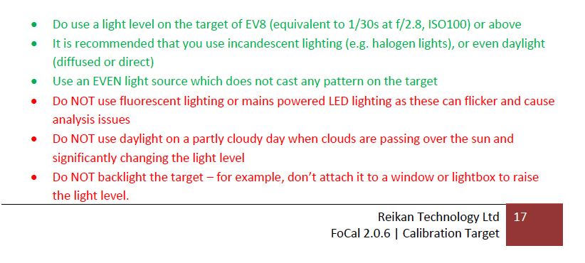

All CFLs and LEDs flicker, due to the AC cycling, correct? Also, I am not sure that it is the flicker necessarily that causes focus shifts? I am pretty sure it is the color temperatures can cause issues with the different wavelengths.
TS is correct, it is the wavelengths that impact Af.
However, LEDs are DC devices, and when plugged into a/c, it gets rectified to DC and thus do not flicker. The exception is when pulse width modulation is used for dimming the LED.

My first step was to find daylight balanced incandescents at the hardware store but it was not easy. Everything has gone LED.
Focal warns about LED/fluorescent and about flicker. We have seen results of shots taken in a gym with flicker prone lighting. I thought about the 7D2's anti flicker option so I figured it must effect it somehow after reading FoCa's warning. We know that gym lighting causes exposure shifts but don't recall reading about any focus issues. I must admit I don't have a great understanding when it comes to this at a molecular level so I thought I'd be safe and cover both aspects. This is pretty interesting.

Dec 22, 2015 01:21 |  #5259
gschlact wrote in post #17827952 (external link)
My 11 W LEDs (60 W equiv) do flicker, but I doubt it would cause any issues doing MFA with the dot-tune method.
No biggie in any case. If the MFA was not the best, just do it again. It doesn't take long, and can be done on the fly in the field if you want.

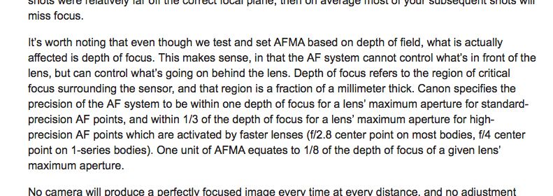

Dec 22, 2015 05:18 as a reply to  @ gschlact's post |  #5260
Since canon themselves state that one mark of MFA is 1/8 the dof wide open, I would tend to believe them and instead believe that when I did this test, when I autofocused each time, the focus simply shifted a tiny bit, not allowing us to fully see the effect.
Canon themselves have confused us a bit, because we throw around DOF, which is really depth of field. Canon, in their technical whitepaper, specificially calls out what MFA covers, and that it is 1/8 the single side of depth of focus. However later, Chuck and others mistakenly change the meaning and tell us it is 1/8 the DOF (which we translate to depth of field), which is incorrect.
This indeed means that each mark is very tiny, and is probably closer to the 1/16 you mention than 1/8, once you take all this in. This means that you can shift the depth of field (DOF) around 2-3 in total, not 5 total as others may believe, if you were to use the entire -20 to +20 range.
Some references:
Online Article wrote:
DEPTH OF FIELD - The range of object distance within which objects are in satisfactory sharp focus, the limits being the establishment of a circle of confusion of greatest acceptable size.
DEPTH OF FOCUS - The range through which the image plane (the emulsion of the film) can be moved backward and forward with respect to the camera lens such as defined under the depth of field and circle of confusion. This term is often confused with depth of field and vice versa.
In common English, Depth of Field is what the photographer is interested in; it is what is in acceptable focus in front of the lens. Depth of Focus is what only a technician is interested in; it is what is in focus behind the rear lens element which the film or image sensor "sees."
Canon 1D3 White Paper wrote:
The focus shift amount per step is calculated by multiplying the maximum aperture's single-side depth of focus by 1/8.
How to do the adjustment? This is from an email by Chuck Westfall:
https://photography-on-the.net …/showthread.php​?p=4522704

Dec 22, 2015 09:16 |  #5261
TeamSpeed wrote in post #17828107 (external link)
Some references:
TS,
FWIW,
8 units in front and 8 units in back of the field of focus at the sensor are each respectively directly proportionate to the front and back dof. So if dof is 50/50 they will be 16 equal units, or if dof is such that it is 33/66, the units won't be equal, but still 8 units in front and 8 units in back.
I have gotten email from Chuck this year with explicit clarification on this issue. He also looped in Rudy Winston to create consistent messaging.

Regarding using LED lights for AFMA... I have high-end lights ($80 and up) that I used once. AFMA turned out to be incorrect. I now use only sunlight, or a 4700k Solux lamp.

Dec 22, 2015 09:54 |  #5265
For something to do 6 months ago I tried to figure out if DO field and distance to target effected MFA results. I started a thread on this. By the numbers below you can see ⅛ DO field will be different.
400mm, 5.6 at 20 ft. Total DOF = .15 ft
400mm, 5.6 at 50 ft. Total DOF = 1 ft
People came and told that that was wrong because it is actually DO Focus even though Canon clearly call it DO Field. They said it was just a reference so people had a visual idea. Personally I can't see how one can't effect the other but I'm not an optics engineer. I got to the I really don't care point anymore point but since this has come up again :-). I spent a lot of time looking around and found interesting articles. This paragraph is from the digital picture.
