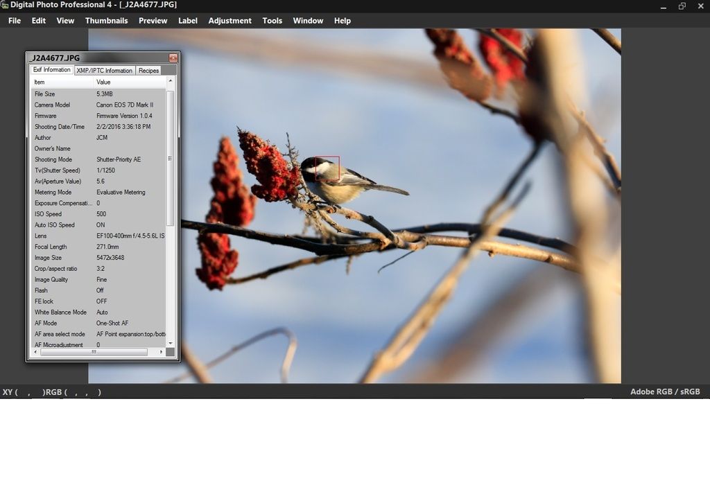

Here are a few examples the Chickadee was around 6 to 8 feet away from me sunny day light at my back no clouds.
IMAGE: http://i1237.photobucket.com/albums/ff461/JM45ACP/4677%20test%20photo_zpsnykrxqzf.jpg
IMAGE LINK: http://i1237.photobuck​et.com …t%20photo_zpsny​krxqzf.jpg  (external link) on photobucket
IMAGE: http://i1237.photobucket.com/albums/ff461/JM45ACP/_J2A4677_zpsvtw74jsv.jpg
IMAGE LINK: http://i1237.photobuck​et.com …/_J2A4677_zpsvt​w74jsv.jpg  (external link) on photobucket
IMAGE: http://i1237.photobucket.com/albums/ff461/JM45ACP/test%20shot_zpssfmqtaad.jpg
IMAGE LINK: http://i1237.photobuck​et.com …st%20shot_zpssf​mqtaad.jpg  (external link) on photobucket

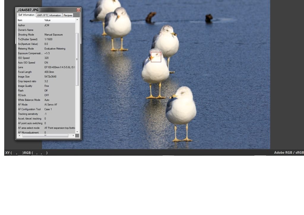

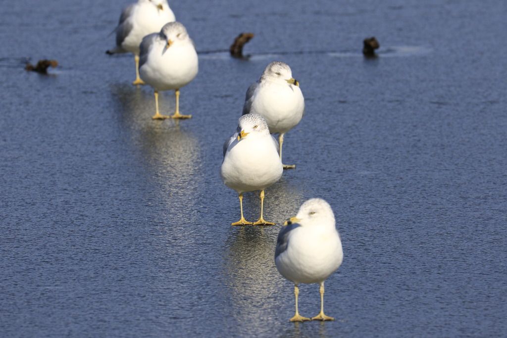

The Gulls were around 15 to 20 feet away again sunny day no clouds sun at my back there is no PP on this shot no crop This is a good shot and what I would expect this set up to do most of the time.
IMAGE: http://i1237.photobucket.com/albums/ff461/JM45ACP/4587test%20shot_zps4ad3q3lx.jpg
IMAGE LINK: http://i1237.photobuck​et.com …st%20shot_zps4a​d3q3lx.jpg  (external link) on photobucket
IMAGE: http://i1237.photobucket.com/albums/ff461/JM45ACP/_J2A4587_zpsvzr8pcce.jpg
IMAGE LINK: http://i1237.photobuck​et.com …/_J2A4587_zpsvz​r8pcce.jpg  (external link) on photobucket

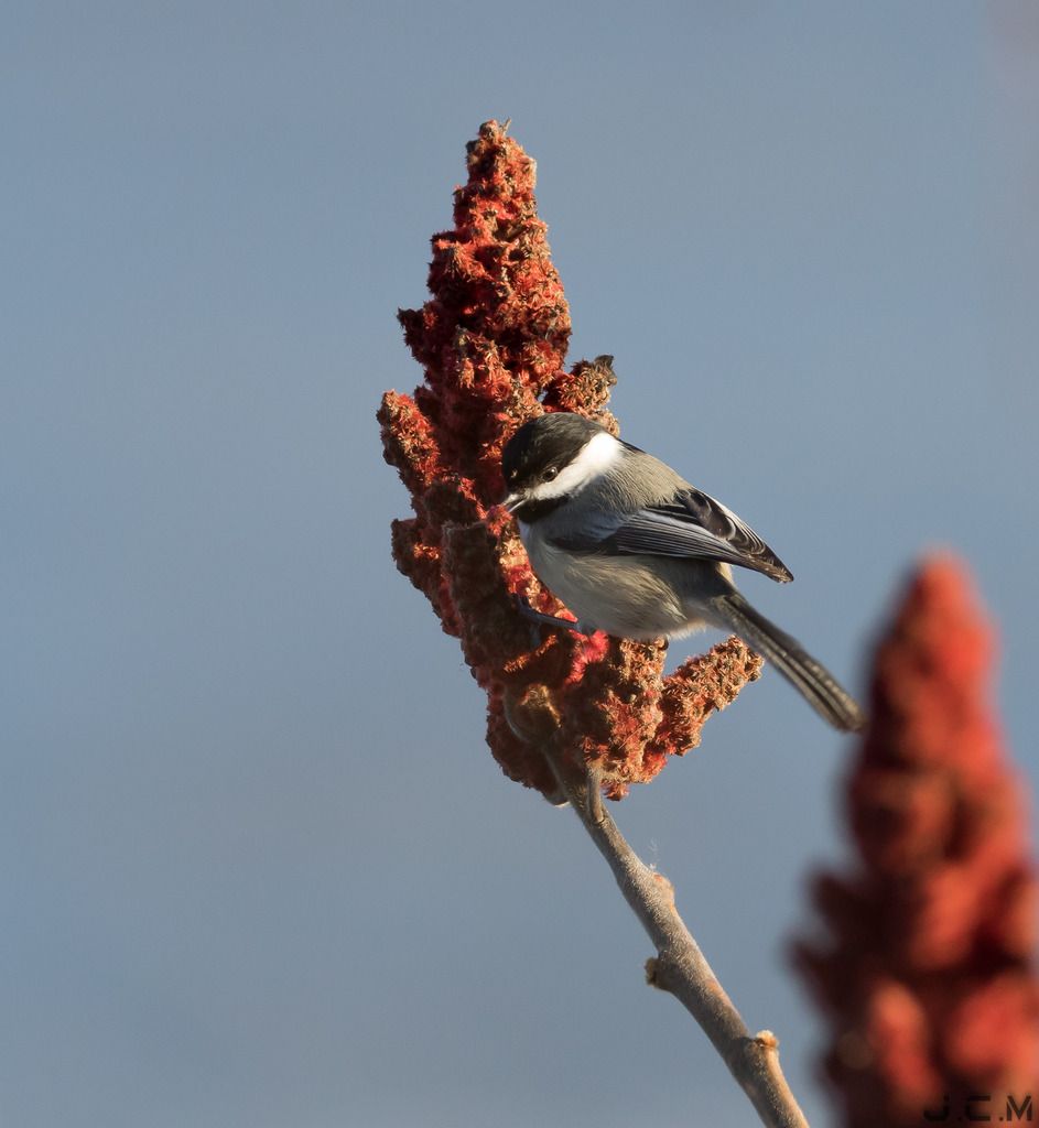

This is one of the few from the other day that were decent
IMAGE: http://i1237.photobucket.com/albums/ff461/JM45ACP/chickadee001_zpsc8j3zhgk.jpg
IMAGE LINK: http://i1237.photobuck​et.com …ckadee001_zpsc8​j3zhgk.jpg  (external link) on photobucket

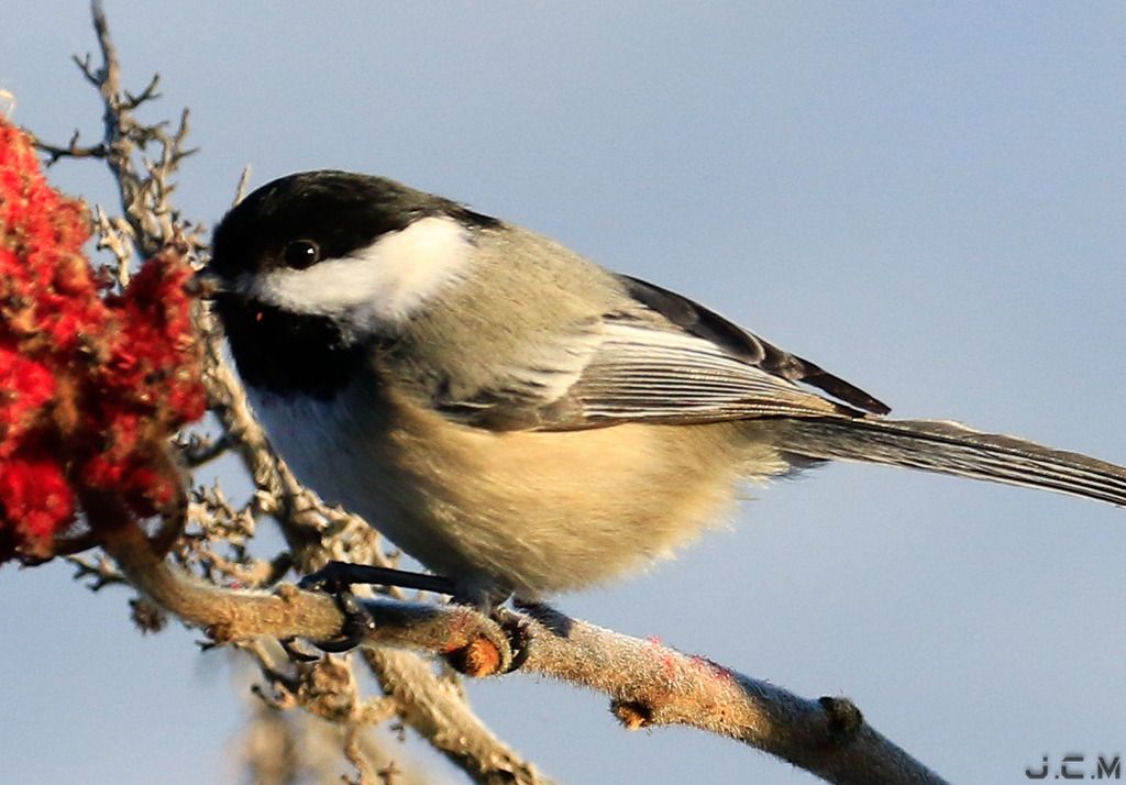

This is an example of what I was getting when I first got the camera with the 70-300mmL
IMAGE: http://i1237.photobucket.com/albums/ff461/JM45ACP/swanchicks25_zpsuojfthoc.jpg
IMAGE LINK: http://i1237.photobuck​et.com …nchicks25_zpsuo​jfthoc.jpg  (external link) on photobucket

On the chickadee shot, your DOF appears to be really thin, in fact not even deep enough to get the whole bird in focus. With such a thin DOF, it would be very easy to get OOF head shots, I would think. On the one you thought was decent had a deeper DOF, from what I can tell.
This is a risk with long lenses. I would often shoot with the Sigma 50-500 at 500mm and f6.3/f7.1 and one would think the DOF would be pretty deep. However shoot anything close to MFD or fairly close, and the DOF is quite, quite small, even at those apertures.
This is my take on the pics supplied, but you know better how you were shooting these (distance wise). Love the gull shot, it is like they all posed in a line for you. :D
From this post, to me, it just seems like there is some back focus going on.

The first of these looks back focused (going by the branch below) but was there any subject movement even if small between achieving focus and the shutter actuation, possibly due to the branch or the main subject? I see from a following post the MA looks good, was the MA test at a similar distance to these subjects?
The second could be a lack of contrast in the main subject plus some pulling from the water ripples behind the head? Again looks back focussed.
I notice you are using AF point expansion for these, TBH I would use spot or at worst single point if they are not really moving much. The reasons being:
1) Although the frame shows the "current point" over the subject an early point might have been in play before shooting biasing the servo estimate of the ideal focus plane. (My understanding is it will use an assist point if the main point has insufficient contrast; also not sure what it indicates if it uses an assist point, might just show the main point, but I don't have anything to support that: I feel an experiment coming on... :) ).
2) The focus points are a lot larger than indicated and can be misaligned from the indicated location depending on the body, this is why I would use spot focus to constrain the focus area as much as possible.
