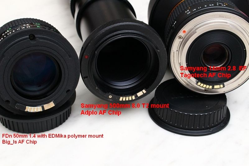

Not all AF confirmation chips are created equal. There are 1st gen, 2nd gen, 3rd Gen, and 4th Gen. I think only the "EMF" versions work with some of the latest cameras from Canon. My SL1 is an exception as it does work with early generation Non-EMF AF chips while my 5D3 does not.
Here is some more info on the various Generations: http://photo.stackexch​ange.com …m42-lens-canon-dslr-adapt (external link)
No chip on the adaptor: your camera will say act as if no lens is attached. some cameras force you to enable shooting without lens. Focus confirm doesnt work. EXIF data may be difficult to handle.
1st generation: Requires MF mode. fixed exif 50mm F2 (or whatever other number they chose for you), focus assist works. Auto focus tracking modes do not work. ETTL cant negotiate the correct numbers.
2nd generation/3rd generation - no EMF: like 1st gen but better built (3rd gen better built than 2nd gen), fixed exif 50mm F1.4.
2nd generation/3rd generation - with EMF : you can now program the f and F numbers yourself through the aperture dial (not user friendly interface), which helps you with EXIf data and ETTL metering. AF microadjust allows you to calibrate back/front focus.
4th generation: Advanced EMF, AF simulation allows AF modes to be used which means old cameras that require a lens with AF to give focus "beeps" or "lights" will work, and AI focus will work, too. Focus locking works as well. These cost quite a lot.
In my opinion the best one is the Euro Dandelion AF Chip sold by Tagotech. It is more expensive, but is better designed, is fully programmable, and looks nicer as well.
http://www.ebay.com …EMF+Program+Chi​p&_sacat=0 (external link)
I currently have three manual focus lenses with Canon EF mounts, each with a different Programmable AF Confirm Chip installed. All three work on the 5D3 so I expect they would also work on the T4i, T5i, 60D, 70D, 7D, 7D2, 5D2, 5D3, etc
Canon FDn 50mm 1.4 with Big_Is AF chip (programmed to 50mm f/1.4) (factory default)
Samyang 500mm 8.0 with Adplo AF chip (programmed to 500mm f/5.6) (due to f/5.6 AF limit on the SL1)
Samyang 14mm 2.8 with Tagotech AF chip (programmed to 14mm f/2.8)
Big_Is chip
http://www.ebay.com …canon+&_sacat=0​&_from=R40 (external link)
Adplo chip
http://www.ebay.com …Tubes&hash=item​3f2ebb0c42 (external link)
Tagotech chip
http://www.ebay.com …onfirm&_sacat=0​&_from=R40 (external link)
All three report the EXIF data as programmed and all three work with both my SL1/100D and 5D Mk III.
IMAGE: http://i2.photobucket.com/albums/y17/msowsun/photo%20stuff/Photo14/IMG_6527.jpg~original
