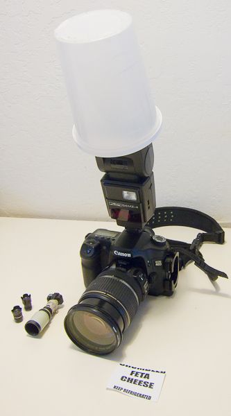

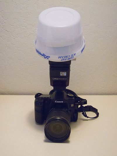

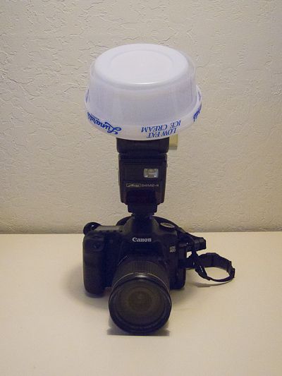

You will find little support for the relatively expensive Fong products here on POTN, when they offer little benefit that less expensive (1/10 the price)) alternatives have to offer.
SIZE matters for 'soft light' and if you have no ceiling to bounce off, all the Fong does is to waste light in all the wrong directions...and for ceiling bounce purposes a product like Fong (or Stoffen) offer little that would not be accomplished by pointing the flash at the ceiling with a small white card creating catchlight in the eyes of subjects.
Outside, they (Fong, Stoffen) are both a total waste of light and more rapid consumer of your precious battery power!
I created these somewhat as a joke, to prove a point, and to demonstrate the ease of making a collapsible design (like one of Fong's).

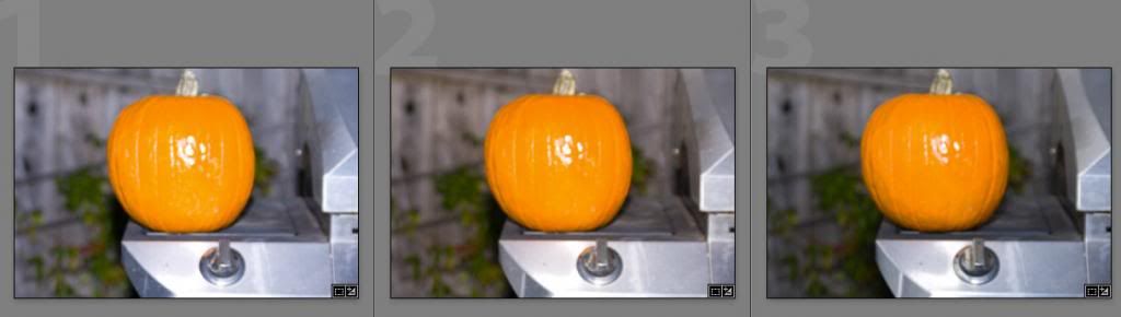

I did a test sequence, 6' from subject (pumpkin, oiled surface to mimic facial oil), flash exposure with indoor ambient underexposed by -3EV, camera mounted on tripod for identical subject framing.
1. Flash native lens only,
2. StoFen sized 'diffuser' (actually a Rosco Hilite flat filter to mimic StoFen on flash head pointed forward, with little light reflected back from ceiling),
3. 5" x 4" LightSphere-like Feta cheese frosted plastic home modifier
IMAGE: http://i69.photobucket.com/albums/i63/wiltonw/barestofenfeta_zpsa3918bff.jpg

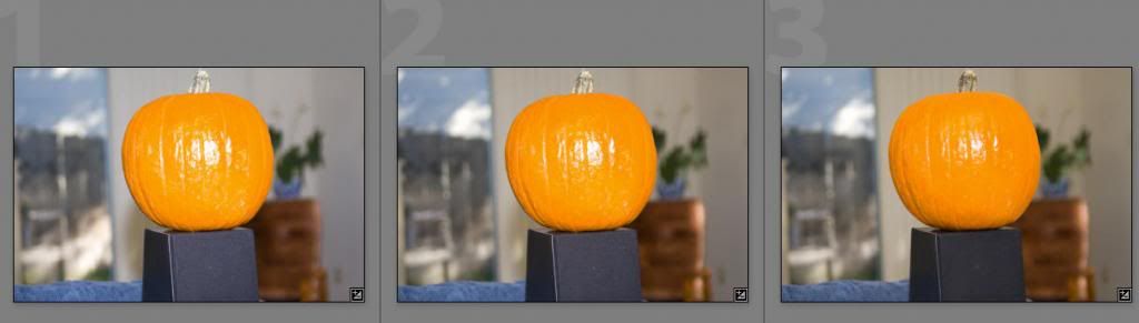

I shot this again, after dark, outside (nothing to bounce off of) after dark
IMAGE: http://i69.photobucket.com/albums/i63/wiltonw/barestofenfeta2_zps1b24ded0.jpg
