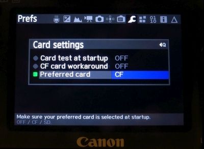

It is certainly possible for Canon to add this because Magic lantern has included it as an option.
Here is what the ML menu item looks like....
IMAGE: http://i2.photobucket.com/albums/y17/msowsun/photo%20stuff/Photo15/IMG_0771.jpg~original

I hear these work arounds being suggested, and they are fine for slow days. When one is shoot the snow goose migration or a morning shooting yellow bill cranes in Africa followed by a large elephant herd crossing, leaving the card door open isn't an option. You swap cards when suddenly you notice you've lost your burst rate (i.e. you are now writing to the SD card). Then you change cards and keep shooting. Later in the day you do file transfer to the laptop and external hard drive.
Yes, I can and do manually shift back to the CF card, but having to do so is basically a Canon software flaw that apparently can be fixed based on the Magic Lantern comment above by MSOWSUN. I've never installed magic lantern as I didn't know if it voided any Canon support, but maybe that is my answer.

The 5DIII has a sweet tooth for SD.
Using ML or just using the CF as only card is the only sollution.
