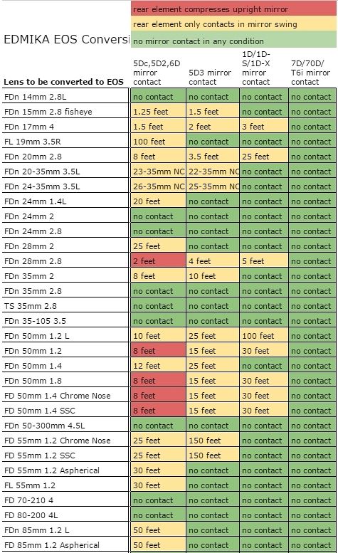

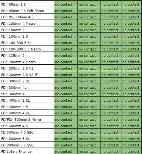

Some FD lenses that have been modified to fit EOS will hit the mirror, but this only applies to Full Frame cameras and only when focused at farther distances. Since you have a crop camera, it would not have been a problem at all.
Here is a sampling of which lenses may contact the mirror and at what focus distance they may start to contact the mirror. (all lenses over 85mm do not contact a FF mirror)
The chart comes form one of the EdMika ads on ebay: http://www.ebay.ca …er%2Fadapter+ki​t&_sacat=0 (external link)
IMAGE: http://i2.photobucket.com/albums/y17/msowsun/photo%20stuff/Photo15/EdMika4a.jpg~original
IMAGE: http://i2.photobucket.com/albums/y17/msowsun/photo%20stuff/Photo15/EdMika4b.jpg~original
