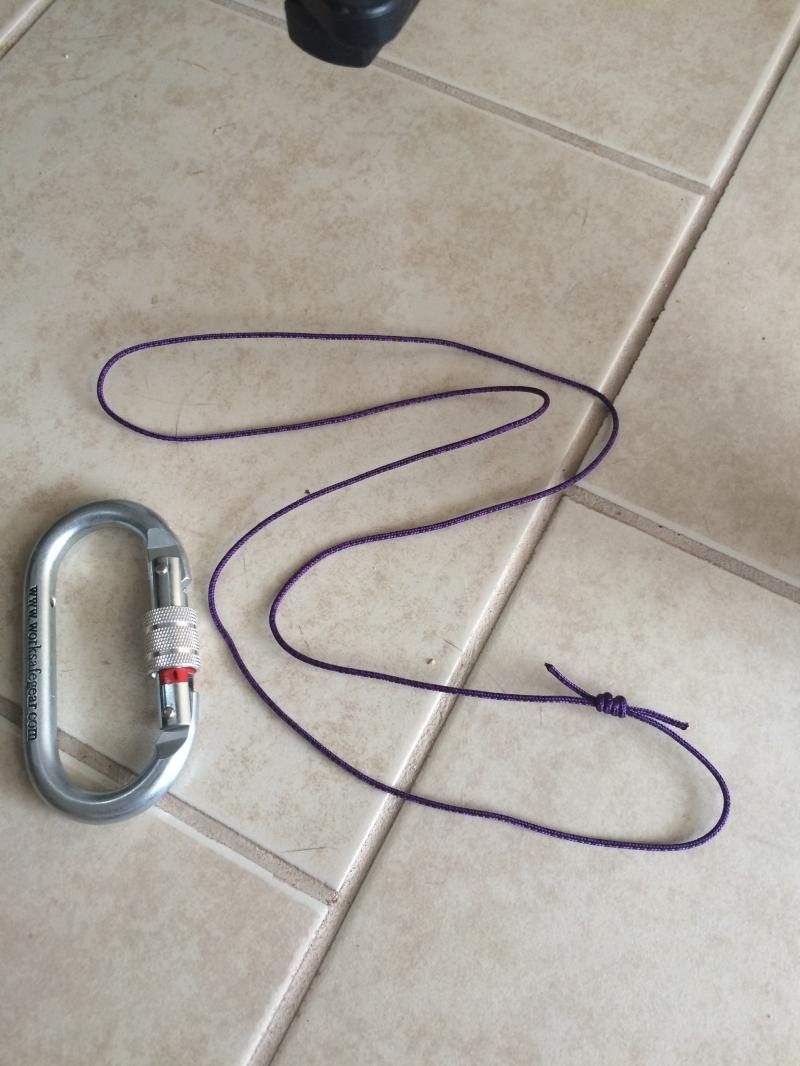

Its easy !
You need a metre or so of thin strong cord (i use 2mm "accessory cord" from an outdoor store, and a small Karabiner (also from outdoor/climbing store)
Heres how to put it together
A metre of thin cord tied in a loop with a "double fishermans" (method for tieing a prusik loop) with a carabiner

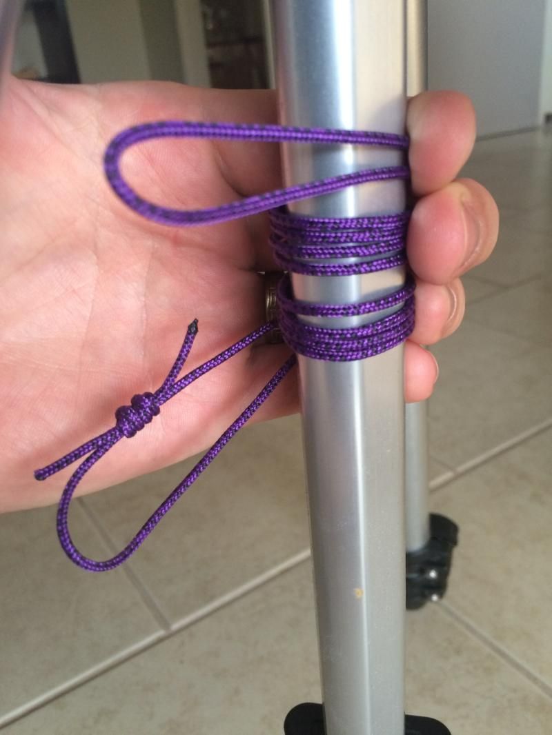

Wrap the cord around the tripod centre column (i did four wraps, less may cause slippage, more requires more cord)

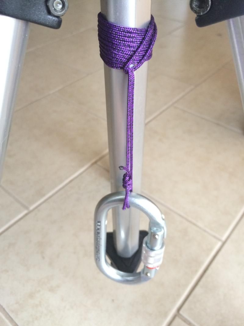

Put the lower loop through the upper loop
IMAGE: http://i103.photobucket.com/albums/m150/Echo63/Other%20Pictures/CA5CC505-1AD8-4887-97EB-E8D74133B658_zpsoqr7ilqm.jpg
IMAGE LINK: http://s103.photobucke​t.com …B658_zpsoqr7ilq​m.jpg.html  (external link)
Dress, tighten and install karabiner and bag
IMAGE: http://i103.photobucket.com/albums/m150/Echo63/Other%20Pictures/ECCA0CF6-5996-4FF1-9ECE-C9CCBA831C2C_zpssz6kni7l.jpg
IMAGE LINK: http://s103.photobucke​t.com …1C2C_zpssz6kni7​l.jpg.html  (external link)
If you need more help, the animated knots by grog website has directions for the klemheist and double fishermans knots (under the arborist section)
