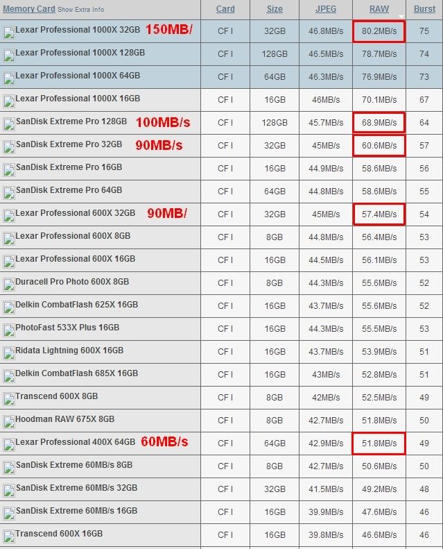

Here is a good site showing the write speeds of various cards.
http://www.robgalbrait​h.com …e7de5.html?cid=​6007-12452 (external link)
Even thought the 5D3 may only max out at write speeds of about 60-80MB/s, you will see that those speeds are only attained with cards that are rated for much faster speeds. You really don't need all that speed as the 5D3 has a very good buffer and faster cards just clear the buffer more quickly. This would come into play when shooting RAW at 6fps.
I would just get a suitably sized Brand name card of at least 300x or 45MB/s
IMAGE: http://i2.photobucket.com/albums/y17/msowsun/photo%20stuff/Photo15/_RG3.jpg~original
133x = 20MB/s
200x = 30MB/s
266x = 40MB/s
300x = 45MB/s
333x = 50MB/s
400x = 60MB/s
600x = 90MB/s
666x = 100MB/s
700x = 137MB/s
800x = 120MB/s
900x = 135MB/s
1000x=150MB/s
1066x=160MB/s

Sadly, the RG Card database is no longer what it was in the past, never updated, and all the historic data removed. :(
That said, one of the key points illustrated in this 2012 snapshot is that the 5D3 was doing 80MBs on the fastest CF fully 4 times faster than the SD cards of the time.
what we can;t see is that newer and MUCH faster SD cards are still slow in the 5D3 as compared to CF cards.

OK, so for EXACTLY the same price ($59.95 usd) Amazon has the following Lexar UDMA 7 CF cards:
64G at 800x or 32G at 1066x
Using the chart above as a rough guide, it seem as though the burst will be measured in the dozens of frames regardless of which I choose. Is that correct?
