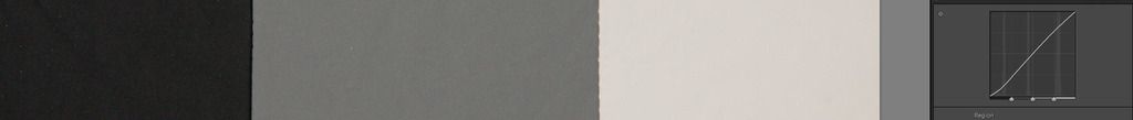

Just to prove that the 18% grey card is centered between 'black' and 'white' of my target pattern, I decided to include the grey card in the photo so three spikes can be seen in the histogram, when exposed per my Minolta Autometer Vf incident meter.
IMAGE: http://i69.photobucket.com/albums/i63/wiltonw/Principles/Midtone%20matte%20incident_zpsfkhwjoc1.jpg

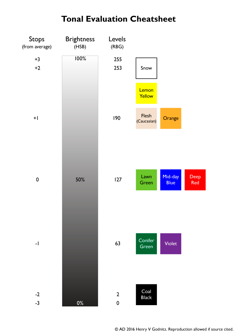

Actually, yes you will, if you follow an incident meter. If, on the contrary, you let the camera make the decisions ('full Auto, man! The circuitry in this thing is more modern and smart than those archaic hand-held relics!'), you will not get the desired results a lot of the time.
As Wilt's experiments shewed, the incident metering was spot on (pun intended, you'll see why below) every time. It seemed to be off once, when metering the chequered pattern printed on glossy paper, but it wasn't really: you don't expect solid blacks from a glossy surface that is reflecting light, however diffused.
Here's a better explanation than I can provide: Black is light, White is dark (external link) (!!).
Spot on. Spot on. I mean, if you don't have a hand-held meter, then get your camera out of those silly übersophisticated and unreliable modes and set it to Spot Metering, then meter off a surface that is a mid tone, then use the readings the camera suggests.
Here, help yourselves to a tonal value cheat sheet.
IMAGE: http://diamantstudios.ca/Gemeines/Bilder/Tonal_evaluation_cheatsheet.png
