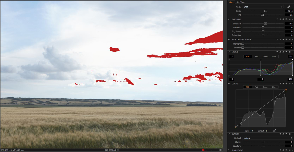

Aug 24, 2016 14:54 |  #16
Alveric wrote in post #18104865 (external link)
However, had I been of the ETTR mindset, I woulda gotten this:
Not the true tonal values and a washed out sky from which some detail might be utterly irretrievable.
**Yes, I know no photo perfectly matches real life due to many factors, like manufacturer's coded-in 'styles', RAW engines, &c. 'As in real life' means as close to the real thing as possible, no 'creative deviations' at all.
Well maybe I am missing something here, but this would be what you got if you used ETTR by 0.5 stop, right?
In that case shouldn't you bring down your exposure by -0.5 in post processing then?
As I understand it, you deliberately overexpose (a bit) in camera and then underexpose (a bit) in post, thereby revealing more details in shadow areas. If you do not, all your images would just be overexposed images, right?

Aug 24, 2016 15:54 |  #18
D-Noc wrote in post #18104904 (external link)
True, spot on in fact, but his point was if you expised ettr and it was clipping the highlights as a result, then you haven't any detail to pull back in the first place, zero data is zero data, therefore in that instance, ettr was not a good method.

Aug 24, 2016 16:39 |  #20
Yes, indeed. Your reasoning is correct. The problem is that you either have to take notes for every photo as in the days of film, or you have to be able to remember exactly by how much you overexposed so that you can pull it in post-processing. When we're out shooting dozens of photos, running all round the place, with many other things in our minds besides pictures (such as quickly pulling off the gravel road to avoid being destroyed by that huge, oncoming combine, &c) it's nigh impossible to remember just how much you went off the right exposure values. Guess you could record them by, er, well, taking a photo? :rolleyes:
And to what purpose, really? Just so as to be able to pull detail in the shadows that's not really relevant? Maybe that's why the sensor designers designed to have only ~25% or data on the left side of the histogram: it's gonna be underexposed and mostly unseen anyway!
I mean, if a man has the time and the inclination and the ability to be taking notes or the exceptional memory to remember, ETTR might work very well for him. But in the field, when you need to record accurate photographs, it's just not practical.

D-Noc
286 posts
Gallery: 49 photos
Likes: 451
Joined Aug 2011
Location: Denmark
Aug 25, 2016 05:20 |  #26
Alveric wrote in post #18104983 (external link)
Exactly. But I guess it all depends on how true-to-life you want your image to be. If you use ETTR right up to the point where the clipping would occur, you should be able to pull it down by -x in post to get a natural looking image. But x might not be exact same amount as you overexposed with when you ETTR but in practise, does it matter much if the image is still LOOKING natural?
As stated earlier I don't use ETTR as such, but my 6D does seem to leave most of the histogram on the dark half if I set the exposure as suggested by the built in metering. So I overexpose by ~1/3 to 1/2 stop to get a better centered histogram. In a sense this is ETTR, but not to overexpose at all, more to get exposure right. The right amount of additional exposure will of course also be dependent on the subject.
I still prefer to get exposure as close to what I really want in camera. I think in regards to my way of handling a camera, ETTR is just an unnecessary step, as I haven't yet had an experience where I thought "Phew.. Im glad I used ETTR".
