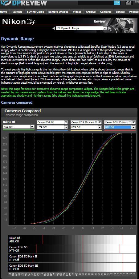

Of course, on POTN we are mostly considering digital (so ignoring points 1-3), where so many think 'Canon vs. Sony' and the 11-12EV DR in Canon and the 13DR of Sony. Look at this comparative illustration of the high end of the range of brightnesses ...
IMAGE: http://i69.photobucket.com/albums/i63/wiltonw/Principles/noiseoffdynamicrange_zps976f7986.jpg
and the highest point on the range is different for the 6D vs. the 5DII/5DIII. Or there is this comparison...
IMAGE: http://i69.photobucket.com/albums/i63/wiltonw/POTN%202013%20Post%20Mar1/NR%20Max_zpshdq19put.jpg
We see hard evidence that the 'point of clipping highlights' varies by camera model. It is here that the histogram has value not addressed by an incident meter.

    Wilt wrote in post #18106326 (external link)
    I just set my 40D on JPG, shot a white sheet of paper and a real 18% gray card. and the LR readings were 54%(out of 100%) and 57% (out of 100%) in LR, and with Paintshop Pro it read about 130/255 and 137/255.
    Yes I have seen ability in the 40D image to underexpose by -3.5EV difference, yet I could still discern the crosshair mark seen in the Photovision target pictured earlier.
    But wait, if my 40D and the most recent 5DIV will BOTH put that same photo at 128, just where does your calculation account for improvement/difference in the brightness (if any) and the considerable difference in the noise floor and the major difference that exists at the low end?! Post 39 illustrations #2 and #3 show different number of segments (14-17 segments) to the right, where the sensor finally quits differentiating, yet on a scale of 0-255, 255 simply is 'max' and fails to distinguish 14 steps vs. 17 steps. The same comments apply at the bottom side. The location of the Sony 0 is lower than the location of the Canon 0 value on the 0-255 scale, but both are 'max black'
    I'll have a deeper look into DPR's chart. I'm not that familiar with their testing methodology. Thanks!
    Wilt, I'm not sure how you got those values. I set up a white seamless paper on the floor and turned off the lights. I then took a picture with a 200mm lens shot at f/5.6 and with a flash to illuminate it set at 20mm zoom. All this to get an evenly lit image, as much as possible. I opened my result in Photoshop which shows values of about 102, which is about 13% maximum brightness. If I increase the brightness by 3 stops, I will be exactly at the clipping point. This was with the 5D3 and I got the same result with my 70D:
    IMAGE: https://photography-on-the.net/forum/images/hostedphotos_lq/2016/08/4/LQ_809849.jpg
    Image hosted by forum (809849) © frugivore [SHARE LINK]

    frugivore wrote in post #18106388 (external link)
    I simply put a white piece of paper under uniform illumination and shot it in Av mode at ISO 100. Then I shot an 18% gray card under the same uniform illumination and shot it in Av mode at ISO 100. Both stored as JPG.
    I took both the above JPGs, and read them into LR and also into Paintshop Pro. I used the respective white balance eyedroppers to neutralize the image (since it was not shot in daylight). Then I used each eyedropper to display numeric values under the sample point.
    • LR sampler measures on a scale of 0% -100% in tenths of percent, a separate value for R, G, B; 'middle' is 50%
    • PSP sampler measures on a scale of 0 - 255, a separate value for R, G, B; 'middle' is 127 or 128
    That is the procedure I used. No adjustments except White Balance.
