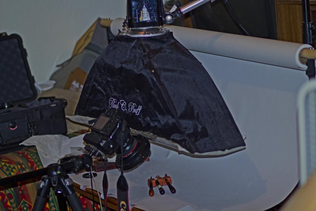

Photographing paper.
Paper is smooth and you might have reflection ( glare ) problem.
I use linear polarized film on the bottoms of my soft boxes and a CPL on the lens .
IMAGE: http://i1110.photobucket.com/albums/h454/mortuarymike/019_zps31136acb.jpg
IMAGE LINK: http://s1110.photobuck​et.com …/019_zps31136ac​b.jpg.html  (external link)
IMAGE: http://i1110.photobucket.com/albums/h454/mortuarymike/029_zps2397bc40.jpg
IMAGE LINK: http://s1110.photobuck​et.com …/029_zps2397bc4​0.jpg.html  (external link)
IMAGE: http://i1110.photobucket.com/albums/h454/mortuarymike/TS%202_zpstyl4hawq.jpg
IMAGE LINK: http://s1110.photobuck​et.com …%202_zpstyl4haw​q.jpg.html  (external link)
