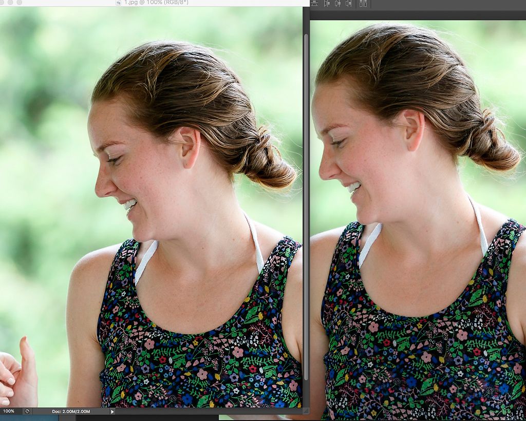

Bit of an older thread. Try my formula. Set LR colour profile to Canon Standard. Clarity is optional but for bird details I like it.
BASIC
Clarity +15
Vibrance -9
Saturation +4
HSL/Color/B+W
Saturation
Yellow +15
Green -6
Blue +10
LR is on the left
