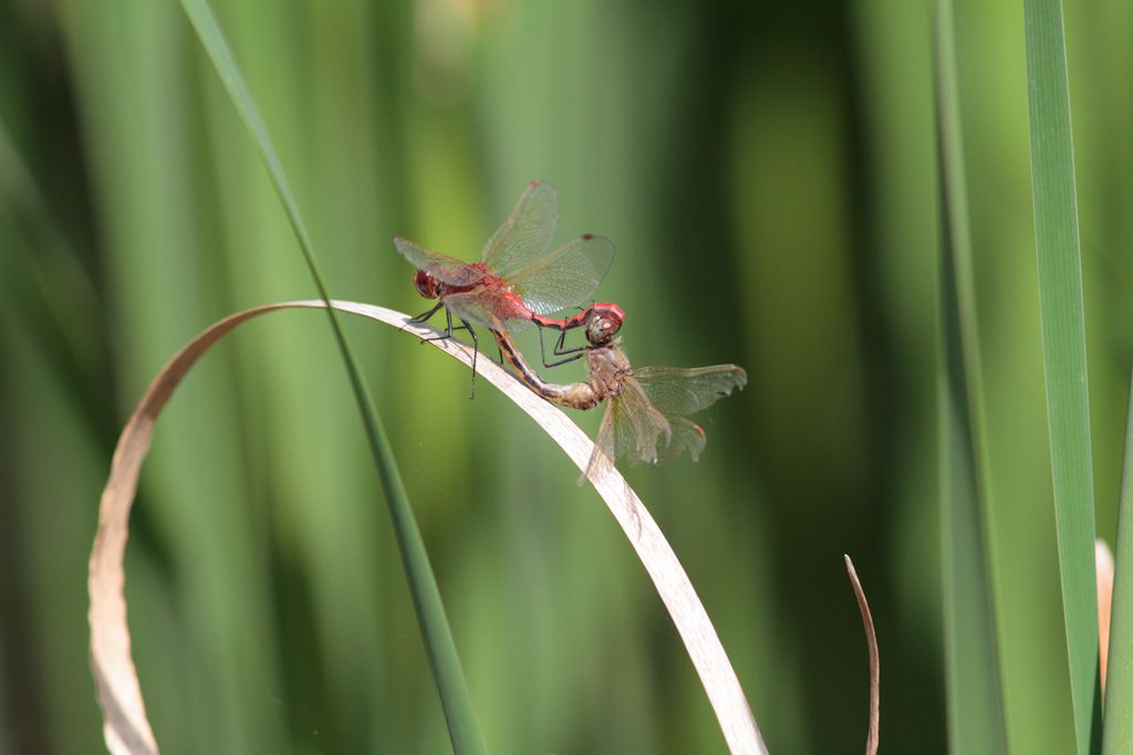

I used to say my 300L F4 IS is so sharp I had to carry bandaids in my camera bag. I owned that lens since 2006 and it produced thousands of tack sharp images. The only reason it is resting now is because I purchased the 100-400 II. It should be just as sharp or sharper than your version of the 70-200. The 70-200 2.8 V1 was the model that was known to be soft.
