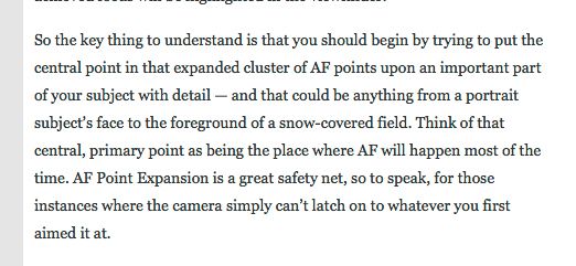

I've alway viewed it as the centre point is the primary at all times. What Rudy Winston says in that link I posted is how I thought it worked since buying by 5D3 when it came out. Even with the assist points I should always try to keep my centre point on what I want to be in focus.
IMAGE: http://i33.photobucket.com/albums/d74/Zenon1/7D2/Untitled_zpsurogx60g.jpg~original
You really can't avoid doing that because it is such a small area anyway. Then I thought the area is so small what significant benefit will faster switching be? If a small erratic bird takes off in another direction it will off all the points in a micro second. I can't keep up to it. Just by that alone I don't think it impossible the engineers could have decided to set assist points at a fixed speed. Save on resources?

Sep 21, 2015 16:28 |  #86
digital paradise wrote in post #17715281 (external link)
The article says that when an AF point shifts the red dot also shifts which does not happen on my camera in AI Servo.
That can only happen wioth the 1D4 in CF 8-3, ie: with the 45 point expansion on.
Does the 1D4 have expansion and zone modes or just expansion?
No zones, they were introduced with 5D3 and 1Dx
... I really just want to know if Art Morris is right. ...
Based on what that article says about the ways expansion can be used/works, the fact that that article is as "straight from the mouth of Canon" as it gets, do you not see it contradicting some aspects of how you interpreted Artie's statement in the video?
