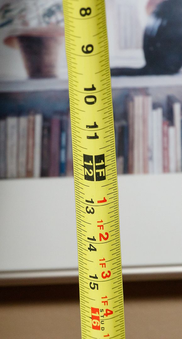

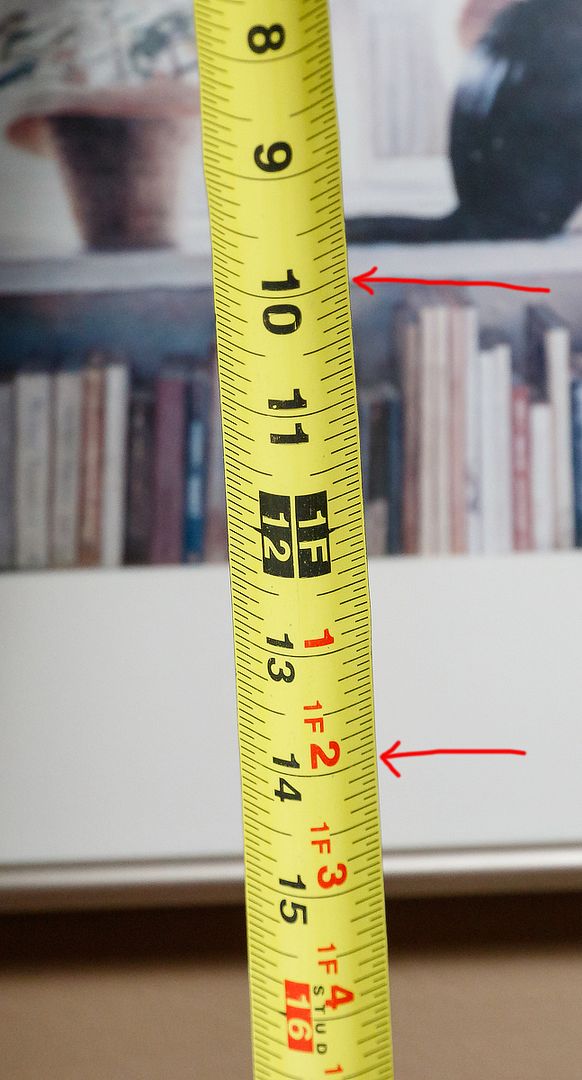

I don't what to say. Test after test and focal all say +14. I just tested my 300L F4 IS.
No TC +4
With TC +5
You clearly see the difference with the 100-400 @ 400mm and it is consistent and I'm not the only one. I also read others are getting what you are. What did your tests without the TC show? Based on what lens rentals says perhaps a small difference in normal body and lens tolerances can throw a zoom at f8 out a lot. Exponential error. It is really not an error, just normal tolerances that will be exploited in a certain direction.
A lens and body both the minus range, a lens and body both in a plus range and both opposite can cause different results how the light waves move trough the TC and lens even when final results being +3 or +14 look good. Just guessing. I'm not an engineer. I know it surprised me.
No MA
IMAGE: http://i33.photobucket.com/albums/d74/Zenon1/7D2/zeroPD_zpssj5viugn.jpg~original
+14
IMAGE: http://i33.photobucket.com/albums/d74/Zenon1/7D2/fourteenPDa_zpssbh2mcnx.jpg~original

I used Lensalign I use to always do batteries and sometimes I still do that but the last time I spent 3 days using lensalign I have used focal as well but my results were all over the place so I stopped using it

I have read about that as well and that was one reason I did not use it. I did notice that early on. The developer has done fixes, etc. Not sure which ones. So far I'm getting consistent results but I'm not done yet.
I have used Lens Align as well. Bases on the ruler images I posted, flat targets (money on wall) and real world results all show the same thing. I don't lens align is going to fix this one.
If I was the only person getting these wacky then I'd say I'm doing something wrong. Archibald had these numbers.
140mm = 0
560mm = +12
I'm getting
140m +3
560mm +14
