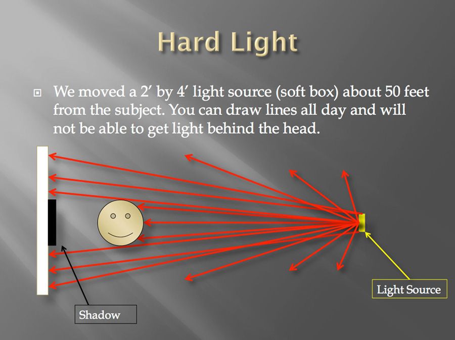

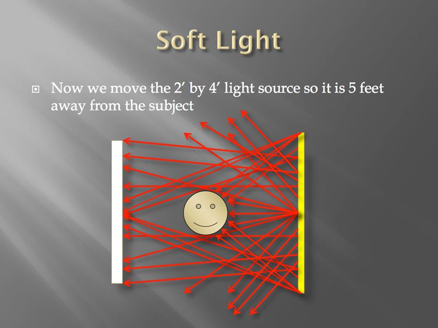

Just to illustrate. There difference between hard and sift light is the size if the light source and it's distance to our subject. This is universal and there are no magic bullets.
IMAGE: http://i33.photobucket.com/albums/d74/Zenon1/Technical%20Lighting/Untitled_zps28f069cd.jpg~original
IMAGE: http://i33.photobucket.com/albums/d74/Zenon1/Technical%20Lighting/Untitled-3_zps2aafaec6.jpg~original
He may as well shot at 90 degrees. Indoors he could have bounced the flash off the ceiling and the bounce card throws a bit of fill light forward to remove shadows under the eyes, etc from the light coming down from the ceiling. The light from the ceiling is much softer because the light from the flash spreads as it gets there, is bigger than the bounce card or bare flash itself and continues to get bigger as it is redirected to the subject.
The ceiling is now the light source, not the flash and acts like a diffuser which creates a big light source.

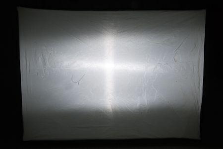

Feathering works with softboxes, but the cutoff on the usual flash lens is too unpredictable...you cannot SEE the feathering in advance, since the light is not continuous (as with modelling lights), and the pattern falloff is a bit too abrupt (especially vertically) as you can see here
Metz flash on 35mm coverage angle setting, shot into a very large softbox (shot previously to illustrate inability of speedlight to fill a softbox evenly when it is too large):
IMAGE: http://i69.photobucket.com/albums/i63/wiltonw/IMG_7606.jpg
Metz flash shot on wall (shot previously to illustrate what happens if flashhead orientation does not match camera orientation
IMAGE: http://i69.photobucket.com/albums/i63/wiltonw/flashpat.jpg
