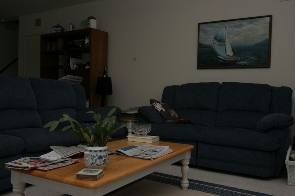

TWO years ago I posted this, when somebody was complaining about 70D flash behavior!
Wilt wrote in post #16521870 (external link)
Back in the days of the 20D and 30D, it was routine that folks would need to almost perpetually dial in FEC = +1 in order to have a well exposed shot with ETTL flash. Well documented by many on POTN threads back then. Then, magically, when I got my 40D that need for FEC went away! Perhaps the 70D just returns to the 'good old days' (good?...yeah right!) of the 20D/30D
Shot with 20D with FEC = 0
